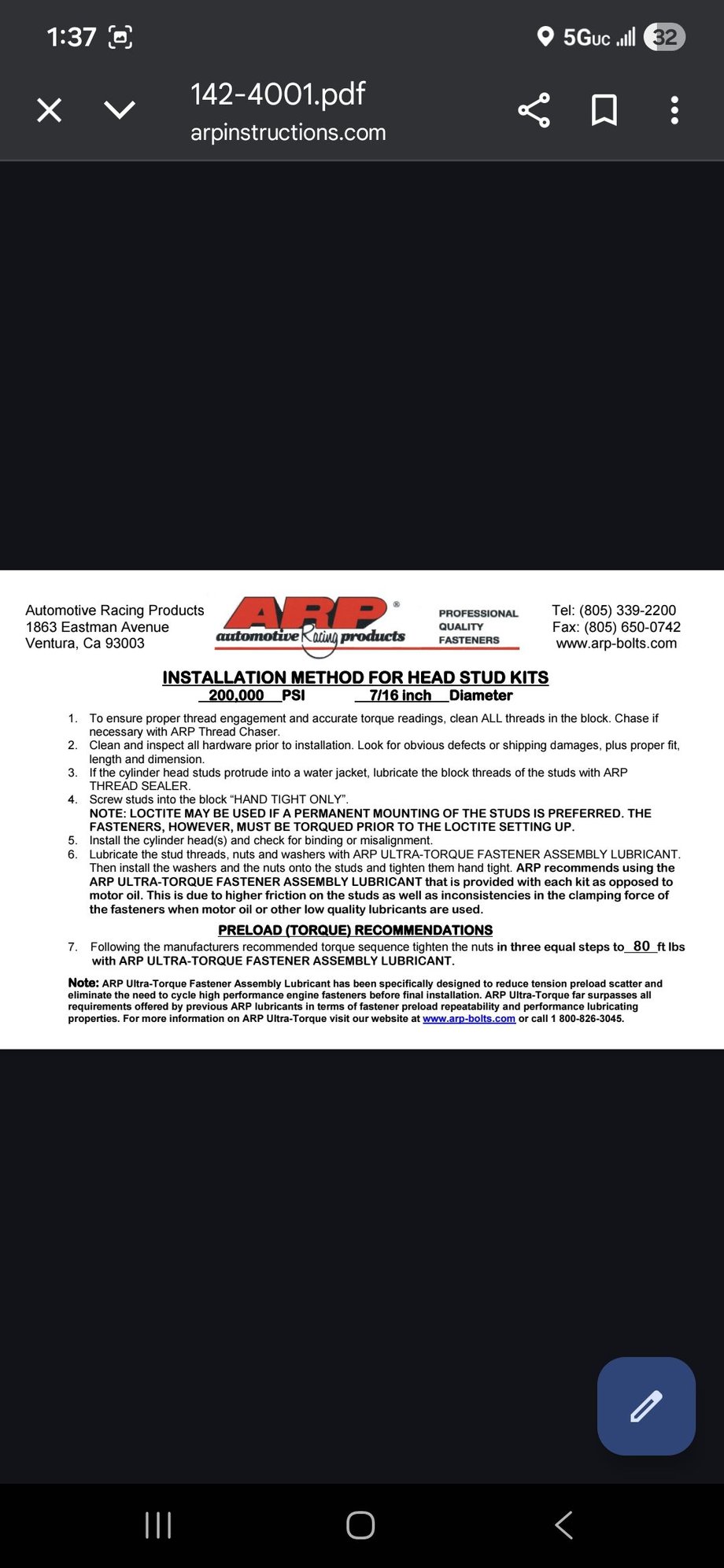

I'm sitting here at my computer with the ARP Head Stud installation instructions in front of me. This is the instructions for LS motors. -&gt; " Torque values are based on 75% of the fastners yield strength. Use the manufactures torque sequence but do not use the engine manufacturers torque specs. Torque the nuts to 70 ft lbs for ARP MOLY ASSEMBLY LUBRICANT (or ARP THREAD SEALER) or torque to 85 ft lbs with 30wt motor oil. Due to the expansion rate of ALUMINUM, it is recommended that the torque should be 65 ft lbs with ARP MOLY ASSEMBLY LUBRICANT (or ARP THREAD SEALER). Note: Do not use any other Moly Lube. Use only ARP Moly Lube or head gasket failure can result." As you can see the instructions are pretty confusing, so that must be the reason for all the diffrent torque values people have been telling you. Good luck.

yep thats what it says on my sheet. seems pretty straight forward to me but let me clarify.
steel/iron heads (i.e. domestic cars) = 70 ft-lbs with the arp moly OR 85 ft-lbs with 10w30 oil.
aluminum heads (i.e hondas) = 65 ft-lbs with arp moly. DO NOT use any other moly or oil. ONLY USE ARP MOLY ASSEMBLY LUBRICANT.

Old Dec 13, 2025 | 10:40 PM
joshlugo1997's Avatar
Joined: Dec 2025
Default Re: Arp head bolt torque specs for b18b?
Same paper i got when i gwt my arp from the box. This is for the head studs that have the nuts
