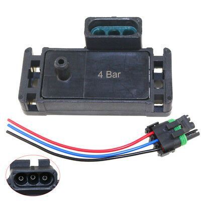

Planning on replacing stock MAP sensor.
Ive found K-Tuned and Omni power 4 bar MAP sensor but what other good brands are out there?

Hondata if using the stock throttle body location.
Dephi/GM 4 bar map sensor. If you relocate it. Even Haltech takes a generic GM 4-bar and re-badge it.
Make sure you actually need a 4-bar map sensor. Those are good to 44.1psi of boost pressure, while even the 3-bar is good to over 29.4psi of boost pressure. And there is just as much availability.

Im using Hondata but how is a GM MAP sensor going to fit on a Honda engine?
We've done it before. It's just not a stock location fit. We use a sealed plate to cover the opening at the TB, and clip/wire the pigtail of the GM 3bar map sensor with the map sensor located on firewall. Even Omnipower makes a GM 'knock-off'.
Older school method. But I still use it on my other car. I don't like anything except OEM sensors whenever possible. But that's just me being a snob.
Great write-up on how to do it..
Video How-To
GM 3bar map sensor install on Honda

As stated, Hondata makes one that is plug and play. I did have one of theirs fail about a year after purchase and they replaced it for free. To Shodan's point, I believe most of the aftermarket sensors are made in China, and quality may suffer.

[QUOTE=TheShodan;52557843]We've done it before. It's just not a stock location fit. We use a sealed plate to cover the opening at the TB, and clip/wire the pigtail of the GM 3bar map sensor with the map sensor located on firewall. Even Omnipower makes a GM 'knock-off'.
I understand your point that your now getting an OEM sensor. First off what vehicle does this GM sensor come off of and how do we know that it is not also made in CHIna?
That is the reason you using the GM 3 bar instead of an aftermarket 3 bar MAP right?
Second, the stock Honda MAP sensor is right on top of throttle body this video shows him installing it but the vacuum reference is now now being captured in the same spot as the stock MAP sensor was. The stock MAP is close to the entire relative air stream entering the intake manifold while this guys new reference I guess is hooked onto a vacuum reference on the intake plenum instead of the throttle body. How will this new location NOT make a difference in how the MAP sensor will read the airstream?
Because it's a MAP (Manifold Absolute Pressure) sensor, and not a MAS (Mass Airflow Sensor).

There are literally hundreds of GM vehicles this came off of from the late 90s-2010s. There is a standard part number for both 3-bar and 4-bar sensors.
3-bars are ‎213-3205 749-7316, and others. From the Chevy Impala to the WS6 Camaro, they're still in production even now. DIYautotuner.com sells the Omnipower ones. :-(
But the best company is AC Delco to get those. You can even find them on Amazon.
AC Delco GM 3Bar Map Sensor AC Delco GM 3Bar Map Sensor
Trust me. This is a Delphi / Aptiv Technologies. No China affiliate for these products (except Omnipower). It's in Automation alley in Troy. I'm minutes from them, Borg-Warner, Continental Tire, and even the old Recaro manufacturer locations.

I’m not sure if you have the stock MAP sensor or the Hondata one, but if you have the Hondata sensor, you might as well leave it as long as it’s not faulty.
As for fitment, the GM sensor can work. In the video link provided, it shows a long vaccuum source from the intake manifold, apparently. Use as short of a hose as possible, although since it’s sensing pressure, it’s just about instantaneous.
If it helps, I’ve used a GM brand MAP sensor with no issues. I’m not sure if it was AC Delco or not, but it could have been Chinese made.

I wouldnt use a hondata map sensor. Ive seen a bunch fail at the worst times.
I have been using a gm 3 bar map for over ten years and no issues. I recently picked up an aem 4 bar map sensor only to replace the vacuum hose and attach the sensor with a proper 1/8 npt to -4 an adapter to the manifold then a line routing away from the engine bay to the aem sensor. This will get rid of a potential vacuume hose popping off at the sensor since it is only a barb connection.
Im doing the same for oil pressure fuel pressure and coolant pressure.
If you end up doing the gm map sensor just leave the stock sensor in place no need to make a plate to block off the port.

Some where there was a thread with someone saying you have to retune Hondata in order to use a 3 or 4 bar map sensor. I thought if you got a 4 bar there was an option to just tell Hondata system what you have and it would calibrate it correctly.
You'll be changing the resolution of the fuel and ign maps. Itll be close but sill still have some gaps thatll need to be retuned.
When you select the 3 or 4 bar map option all it does is rescale the map. Download the software and mess with it youll notice what it does.

So theres no way to change to a 3 or 4 bar MAP without having to retune these gaps?
ALso Im not sure what you mean by change the resolution of the fuel and ignition tables.

Theres about 10 columns Each way. Once you change from a 3 bar with a max of about 29 psi to a 4 bar with a max of about 40 the resolution of each column changes where you had 60 percent fuel for 15 psi itll be off since you wont have a 15psi column anymore. It wont be too dar off but wont be perfect.
rpm. Vac-boost
-20. -10. 0 3 8 10 14 19 22
