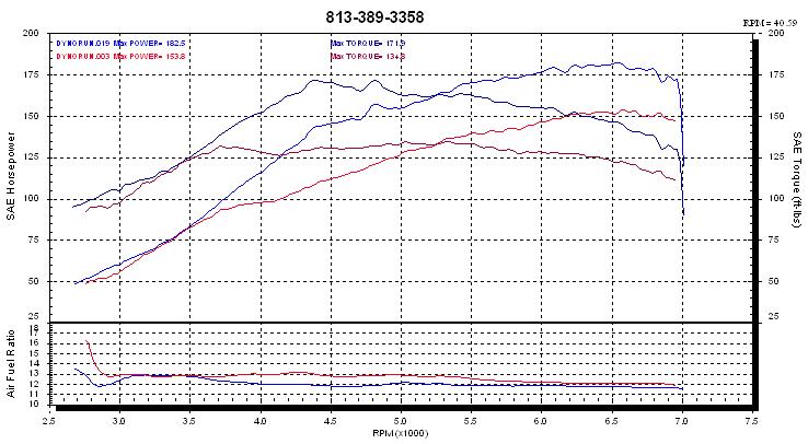

Bone stock D16z6 w/ 180k miles
Greddy turbo kit
DSM 450's
Uberdata
10psi
