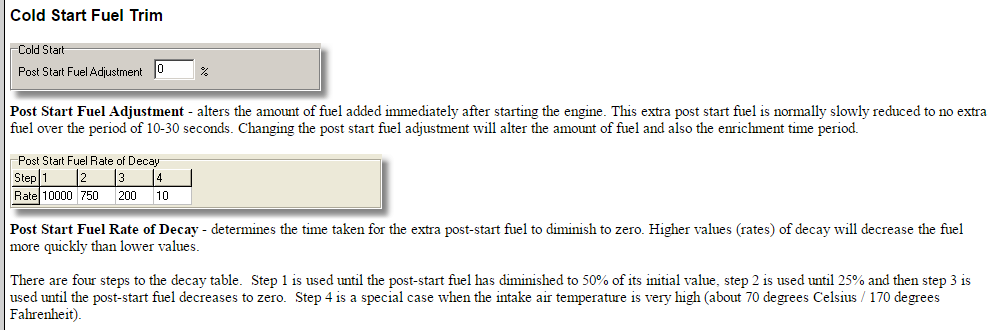

Hondata s300 Programmable ECU Guide
http://www.hondata.com/help/smanager...mpensation.htm

You probably need to go after your temp compensations and your post-start trim/decay.
Columns 7-9 were probably highlighted during/just after cranking at a point where there was not much vacuum built up yet. The logger doesn't know the difference, it's just reporting whatever you tell it to. There's no other reason to be that low on the rpm scale, especially if cold.
