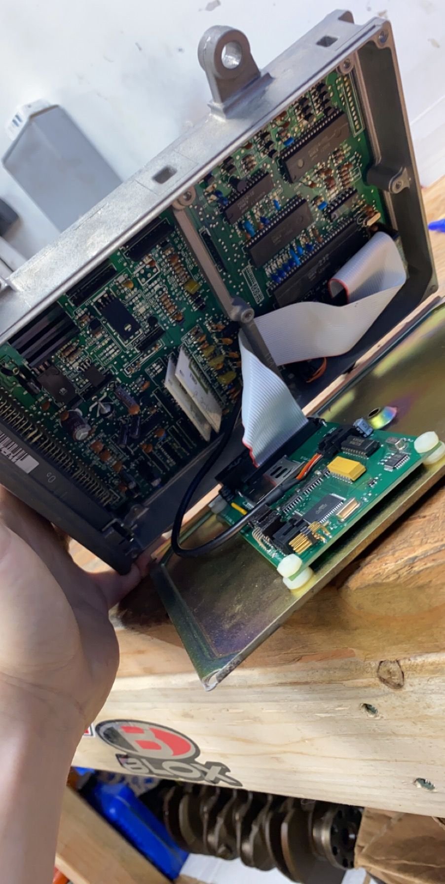

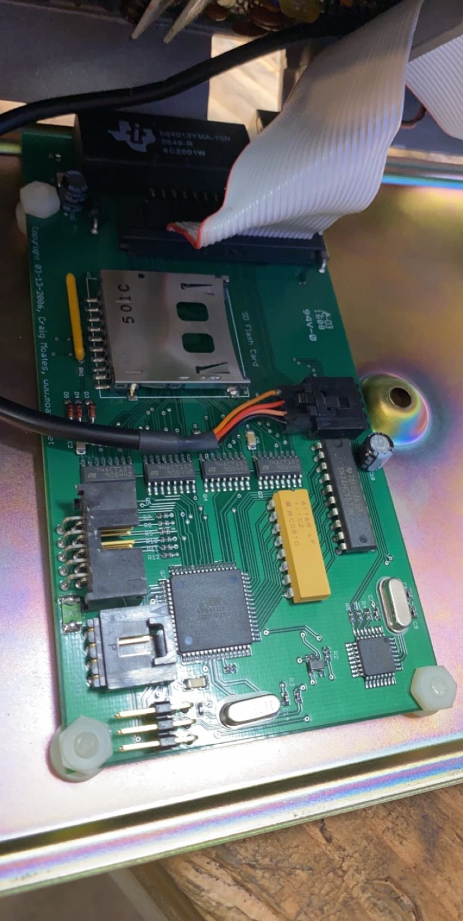

Anyone have any idea what this is? I know it says Craig Moates 2006 on it with the website as well and a bunch of Texas Instruments serial numbers. I looked on the website and can’t find anything. I know it ran my boys b20z2 non VTEC in his 5 speed EM1. The jumper harness to it had a few wires capped off and unplugged and a few weird conversions but seemed to have no problems. And there’s a port on it also to plug into a laptop. Anyone have any ideas?

Looks like one of the original Moates RTP boards which was used with Neptune.
I think your right. I’ve seen one of them years back. These are the Pre Demon boards that moates offered for RTP.

what program would I use for it to tune it do you think?

Neptune should work

Yeah I wouldn’t see why Neptune wouldn’t work on it, you’ll probably have to pay the $250 dollar fee to get the license. But try to download the Neptune program on your computer and connect that to your board. It may have a valid key and be ready to go. I’m not familiar with those older rtp boards. I know some people have ran chrome in a demon as well, but Neptune is a better program as it’s still kept up on and works pretty well for most.

Neptune should come right up on that hardware. I had one that I sold on Ebay for a premium (must have been a collector) and Neptune worked fine on it.
