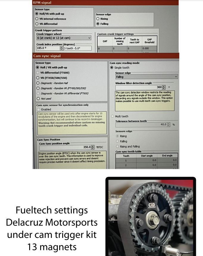

Default Re: Trigger settings for Fueltech ECU using T1 trigger kit
Did you have any luck touching base with Fueltech support, they have always provided top notch responses ? .
Delacruz has a great details on the setup.
