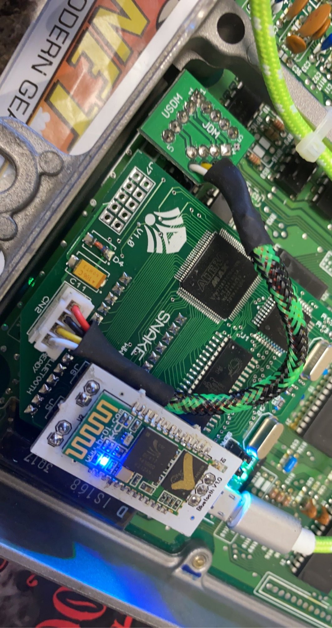

I run it with Bluetooth it works well

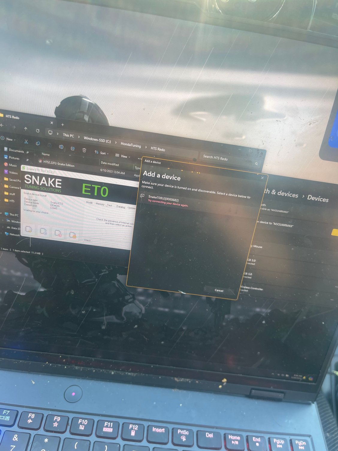

I can’t get my Bluetooth to connect and it’s irritating the **** outta me, the light is solid but it won’t go through on my PC side, how did you get it connected?
Old Jun 6, 2024 | 12:48 PM
DVDr's Avatar
Joined: May 2008
Posts: 1,207
Likes: 14
From: Ottawa, ON Canada
Default Re: Snake Ecu tuning?
try connecting to a phone, see if its the receiving end ( laptop ) , or output signal ( snake board ) .
1) what version of the snake emu do you have
2) have you ever connected in the past.
Also, you have connected to HTS via USB cable correct ? everything is working

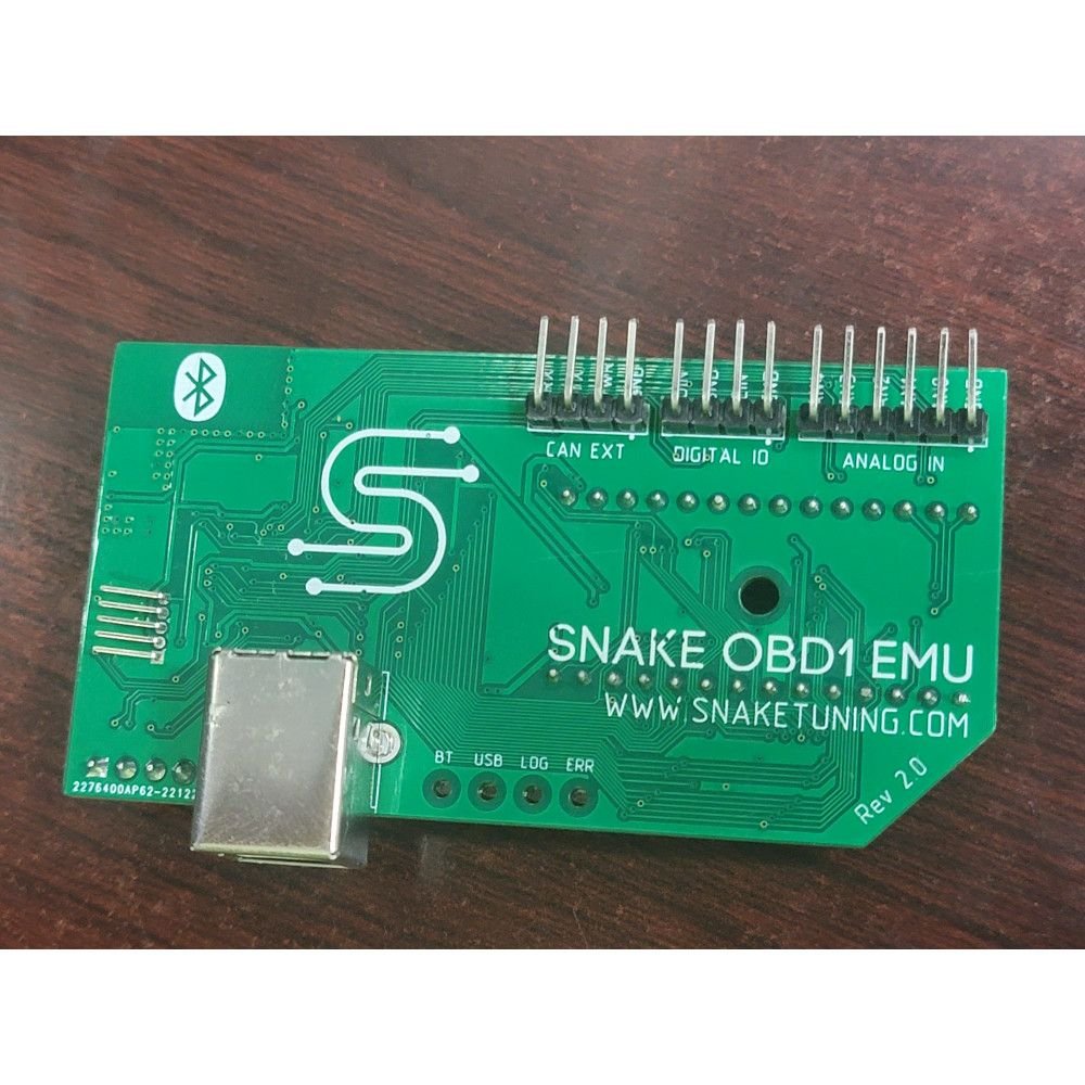

For those who are redirected here. Currently the board is in version 2 and costs around $ 249 USD .
Good locations to get it is from :
https://oxytuned.com/shop/index.php?...&product_id=54
https://boostednw.com/SNAKE-OBD1-EMU
Details on new revision :
Product information
Most capable Moates DEMON replacement with bult in BlueTooth and bunch of unique features. * Easy Connect. Choose "Snake OBD1 EMU" in HTS Emulator Settings. No COM port settings or drivers required (Win 10 and above with HTS 2.22). * Bluetooth. Built in module for wireless capability. * Dual Datalog. While USB connected with HTS and datalogging your Android Bluetooth Dashboard stay functional and datalogging too. * Datalog Keeper. Keep datalog alive while you turn ignition off. It"s help back to datalogging when you turn ignition on 10-20 times faster than standard reconnect to COM port after disconnect. * Analog inputs. 5 onboard analog inputs for datalogging and monitoring data. Dual emulator mode (you can set in service utility) * DEMON mode. All extended features of DEMON board and unique features of Snake OBD1 EMU are here. Set by default. * OSTRICH mode. Legacy compatibility for any software with OSTRICH protocol. What vehicles does SnakeEMU support? Honda Civic’s 1992-2000 Acura Integra’s 1992-2000 Honda Prelude’s 1992-2000 Honda CRV’s 1997-2001 OBD0 Vehicles Requires OBD1 Distributor & Jumper Harness OBD1 Vehicles are Plug&Play OBD2 Vehicles Requires Jumper Harness Highly recommend to use authorized installer SnakeEMU requires soldering of the ECU with the supplied hardware kit. We are not responsible for Incorrect installations
