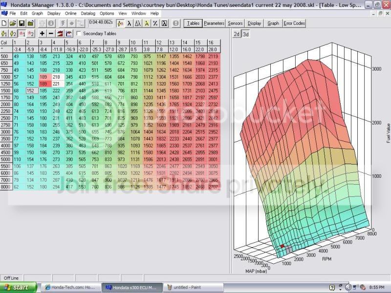

I want to lean this area out a little...where the four are highlighted colum 3 and 4 and at 1000 and 1250rpm.
do i just hit he + icon on top?
If it is, then its not working, what do i have to do?

drag mouse over boxes to highlight, hit minus button, then upload

i've done that, but there is no change in my A/F

Did you hit the minus button just once ?

4-5 times

what are you using to monitor a/f

LC-1 on my laptop

If you want to make sure your wideband is working properly do something drastic such as ctrl a, then ctrl j, 10 percent fuel, click ok.... (Do this to both your high cam & low cam fuel tables)

QUOTE=mtber]If you want to make sure your wideband is working properly do something drastic such as ctrl a, then ctrl j, 10 percent fuel, click ok.... (Do this to both your high cam & low cam fuel tables)[/QUOTE]
what is that suppose to do?[

Add a lot of fuel to your tables...

so do i add 10 to "Percent austment" "Add to selected values" or "Set selected values to"???
