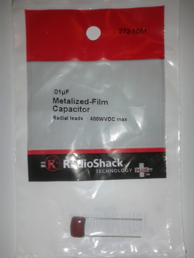

Im about to make this using the fiio6 from the write up.
I bought the smaller capacitors tho. The one you used seem to be for a much higher voltage.
Are they all the same?
Maybe you guys can answer this too. Are all the bosch sensors on amazon the same? I see them range from 10 bucks to 120 depending on make and mode of the car
Yeah theirs certainly room for improvement on the design I made however I was limited by what was available at Radio Shack which believe it or not isnt the same DIY hobbyist store that it used to be 20-30yrs ago.....had a hard time just getting the dumbasses working there to tell me if the capacitors they had available were polarized or not so I found that these worked unlike on my very first attempt in piecing one of these together...

Yeah RadioShack is sadly not what it was, but diy'ers are a dying breed too. Those two combined are why they just filed for chapter 11.
