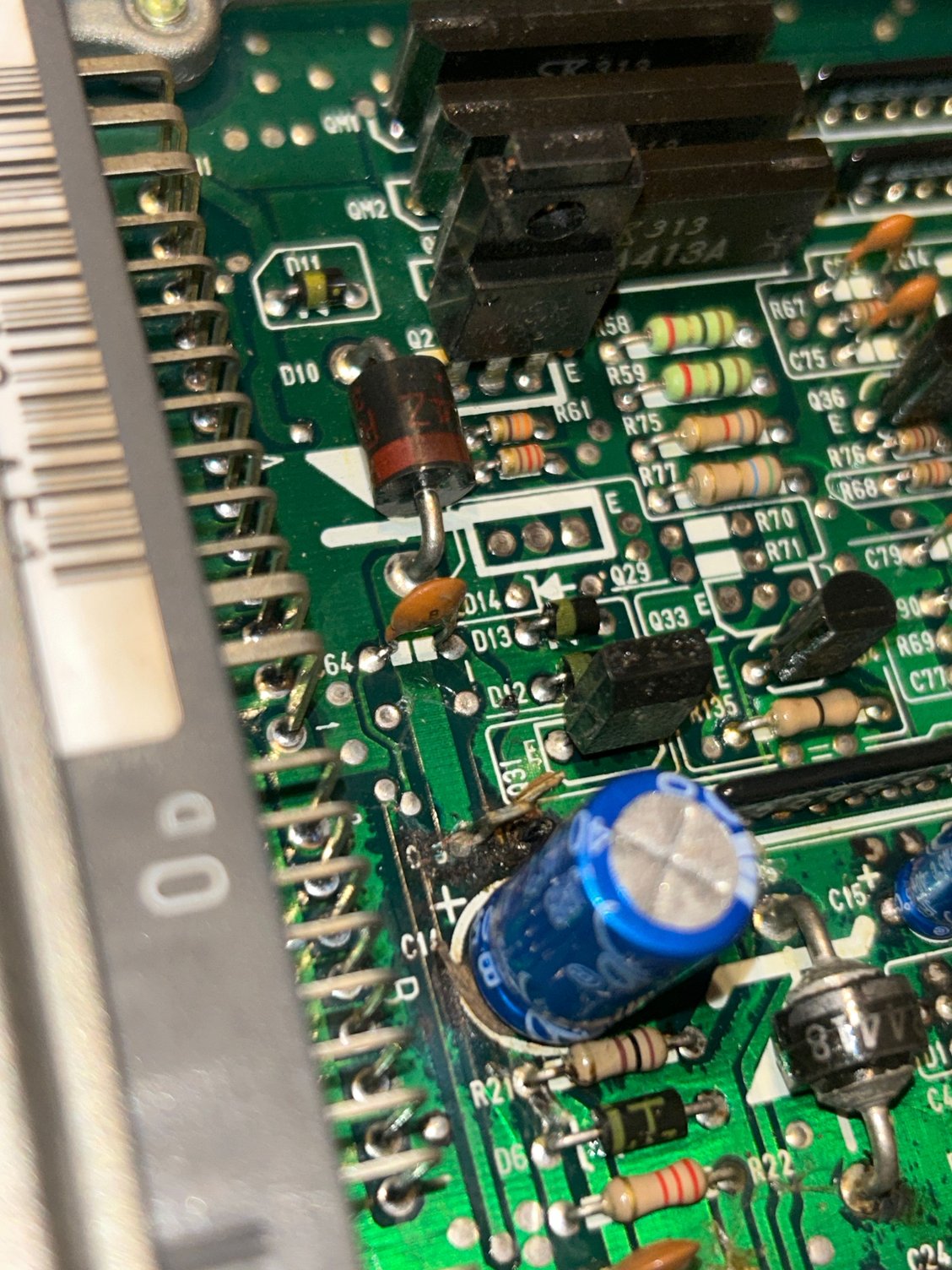

I have a Virgin-ish p28 that I converted to manual and replaced all the capacitors but I noticed one of the orange capacitors I think they are is burnt and I don’t know what they’re called so I can’t find a replacement it’s in c13 I believe can someone help me figure out where I can get a replacement please ecu had worked fine until no spark and no fuel prime issue

That's a .01uf ceramic disc capacitor.
Even if you replace it it may not solve the problem
