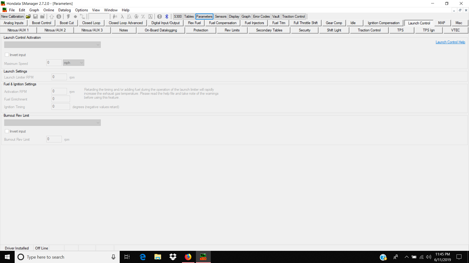

The Hondata V1 needs to be upgraded before the internal battery fails and you start having tune-retention issues. Both systems have more than enough features to effectively tune your combination... the best choice is the one that your tuner is most comfortable tuning. Hondata has "the adjustable launch control" too... so don't let that influence your decision.
It does?

Default Re: Neptune Demon Rtp users
Unless your definition of adjustable and mine differ... I would say yes absolutely.
Neptune can have a variable launch control. You set minimum rpm it will engage and then any rpm with x amount of tps input it will hold that rpm to launch at.
