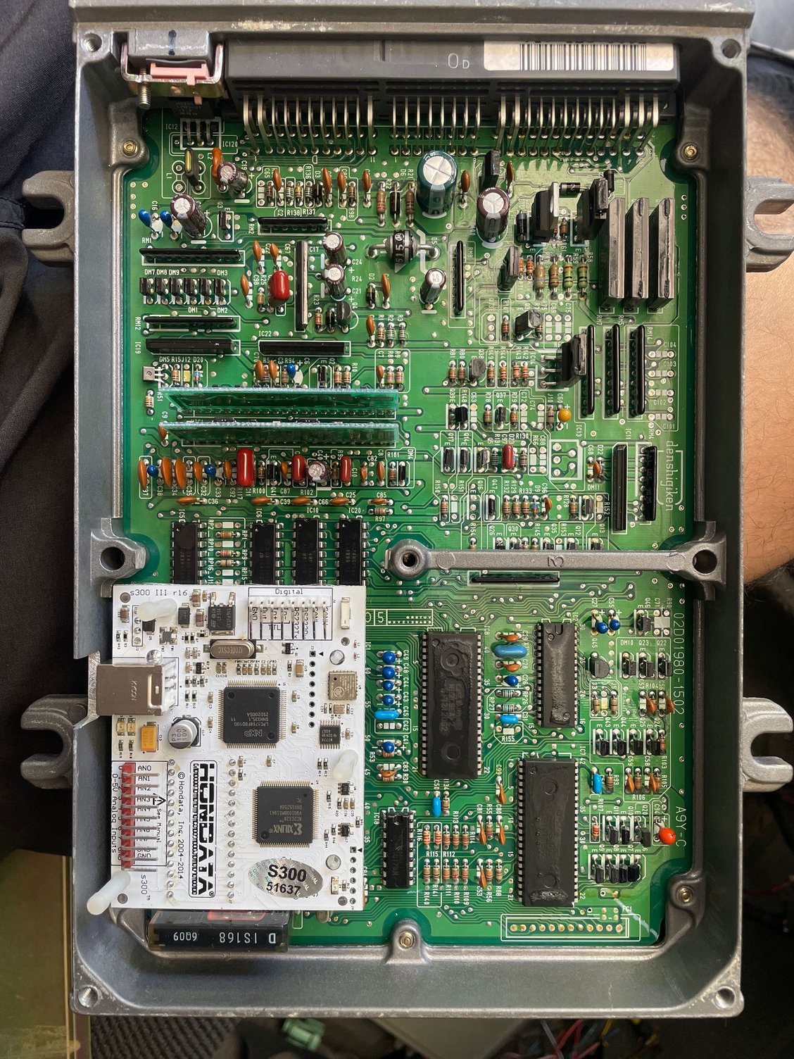

Hey, ive got a P75 ECU with the 1980 board in it. Its got an s300 hondata fitted to it but im wondering if it has had the vtec circuitry added to it. Thanks.

Yes, it has VTEC components installed.

cool thankyou for the quick reply. Do you mind pointing out the the items that give it vtec capabilities if its easy enough? Thankyou.

IC14 does the work. (single taller IC located top right, beside the smaller three black multi-pin parts)
