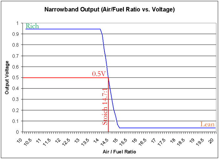

Originally Posted by powertoweight
I was looking up which wire to use as output from my AEM wideband and realized the analog output is 0-5 volts and stoic is 2.38V. Narrowband O2s are usually 0-1V. so I don't think I can substitute the Wideband analog for the narrowband output :-(
I'll try to measure my narrowband output when lean with a scope at lunch today.
Not quite how it works but no, you can't just substitute your wideband's output for the narrowband. Some wideband controllers have a simulated narrowband output that you can use (it's a separate wire) but that won't help you here and they're only really useful if you don't have a narrowband at all and are able to shut off the heater error in your cal. As long as you have a stock ecu you should use a stock sensor.
A narrowband sensor still ha a 0-5V signal, it's just that it doesn't have a nice linear slope to it. It only works right around lambda (in a narrow band!) and is really just a rich/lean switch as such. Further more, a wideband sensor is scaled oppositely from a narrowband. The wideband's voltage output normally increases with increasing lambda (more lean) while a standard HO2S is high at rich and low at lean. That being said, the PHO2S input on your stock ecu is scaled to 0-3.7V, so if later on you did want to use that for your wideband input you would need to clip a component on the board to make it into a 0-5V scaled input.
