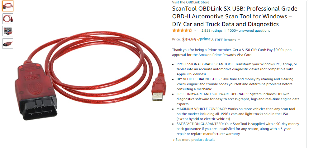

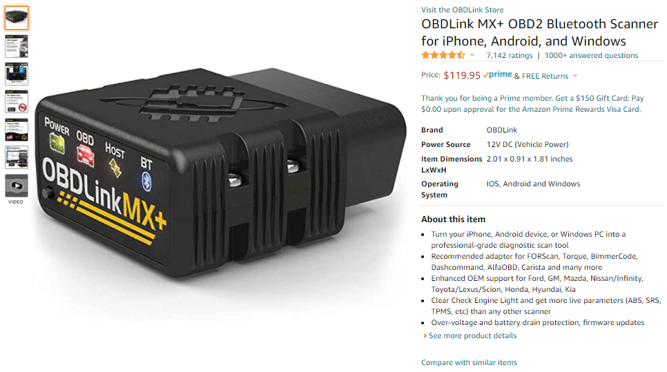

If you have a laptop just get a OBDLink cable or dongle and use OBDwiz. Bluetooth is convenient because you can use it with your phone and their app but the cable is 1/3 the price and cables are more reliable than wireless IMO. The dongles are really just serial converters, once you have one you can use whatever software will connect to them so you're not committed to keeping some contraption around that's obsolete in a year or two.
