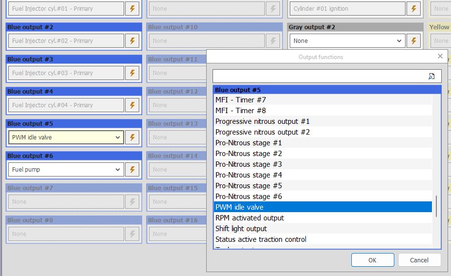

I got in touch with FuelTech and they said it would have to be a blue output. I will have to move my wastegate (blue output) to a gray wire to open up a blue output. See pics below.

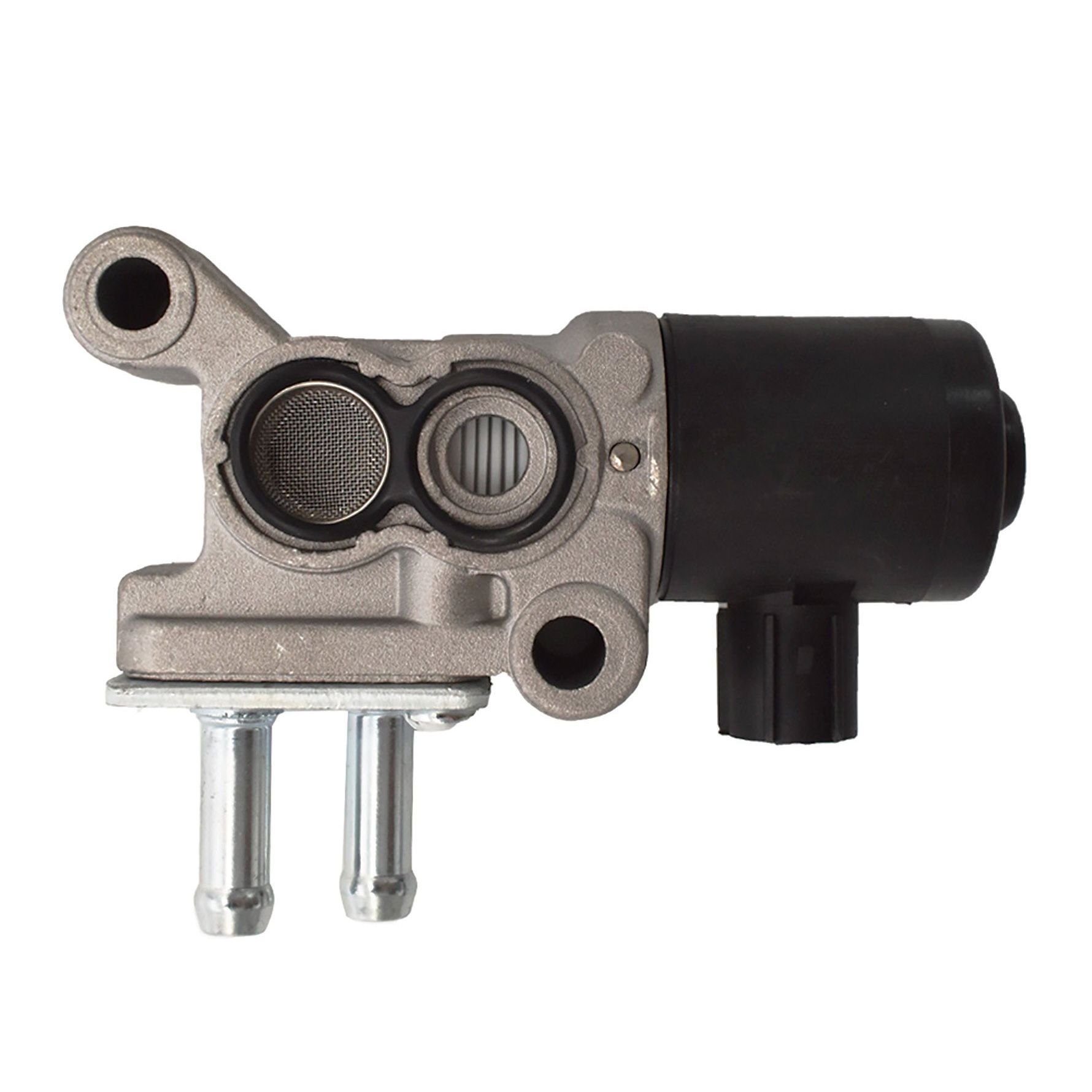

Last question. Do the 2 pin in the IACV have Continuity. Because the one I got has.
I have attached the IACV I have bought.
Old Jun 11, 2024 | 12:27 PM
spAdam's Avatar
Loved
Community Favorite
Posts: 9,763
Likes: 933
From: Boat on a Hill, CA
Default Re: FuelTech and IACV
It's a coil-based solenoid so yes, a basic resistance test will show continuity.

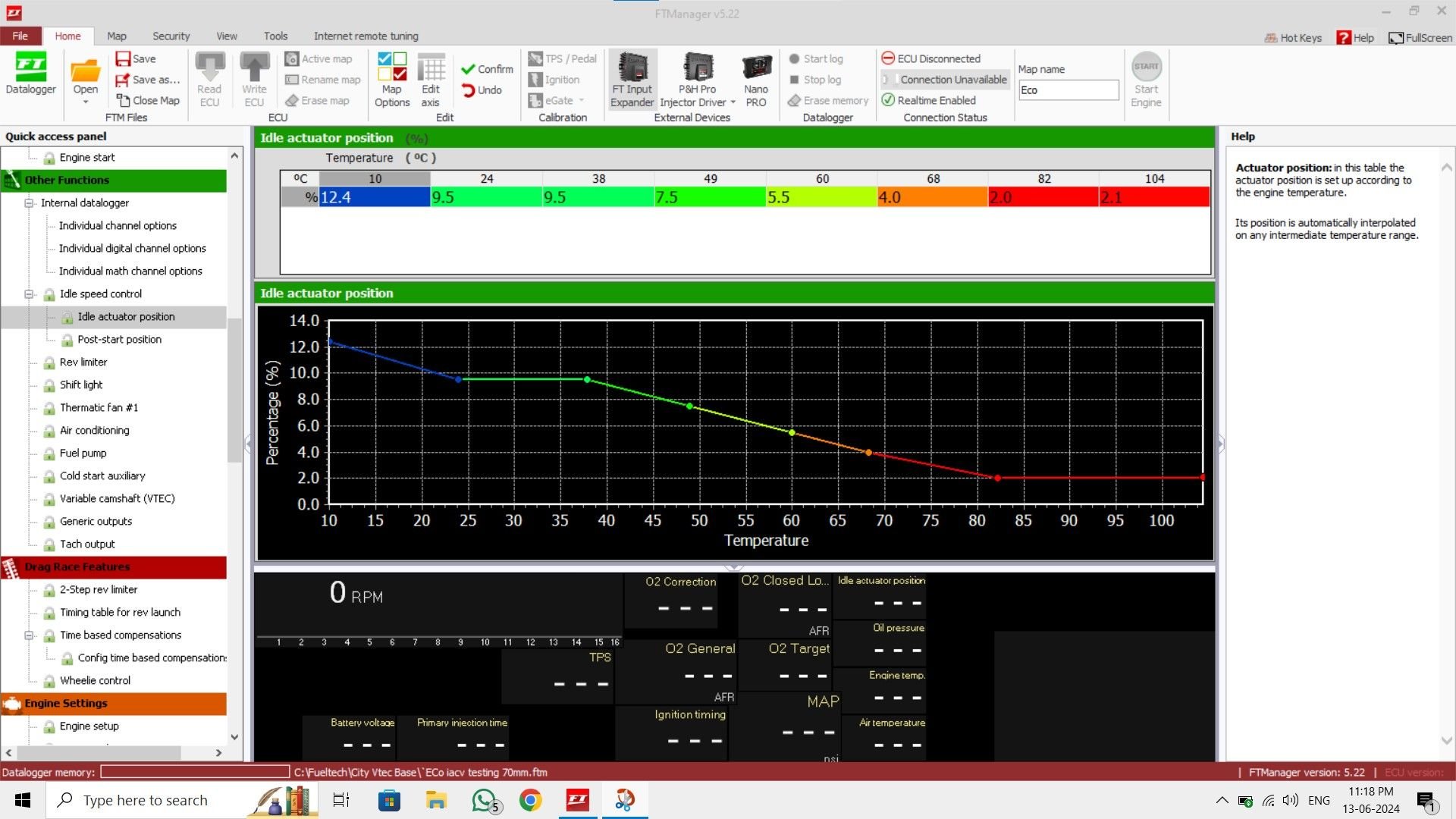

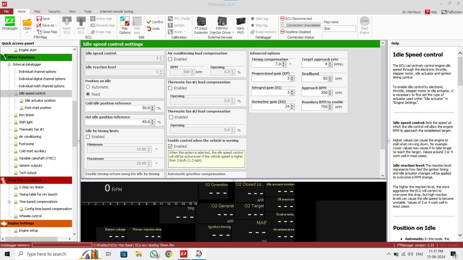

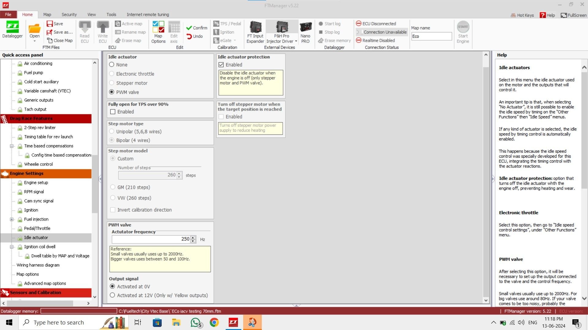

@spAdam Could you clear off ur old msgs not able to send you a text.
I am using a Fueltech FT450 have put I a few setting for the PWM. Could let me know if anything is wrong or where to start off from.
Old Jun 14, 2024 | 08:10 AM
spAdam's Avatar
Loved
Community Favorite
Posts: 9,763
Likes: 933
The settings you have in your snips look like a reasonable starting point. Let the help file be your guide for tuning your ecu. Most ecu companies these days have really good documentation.

Think about it like this, the frequency is the number of times per second it will allow you to make a voltage pulse. The percentage value should be considered a duty cycle, the length of the voltage on-time per pulse. You may need to raise those %s up to get the valve to respond. A combination of duty cycle and frequency will cause the coil to hold the plunger in just the right place.
