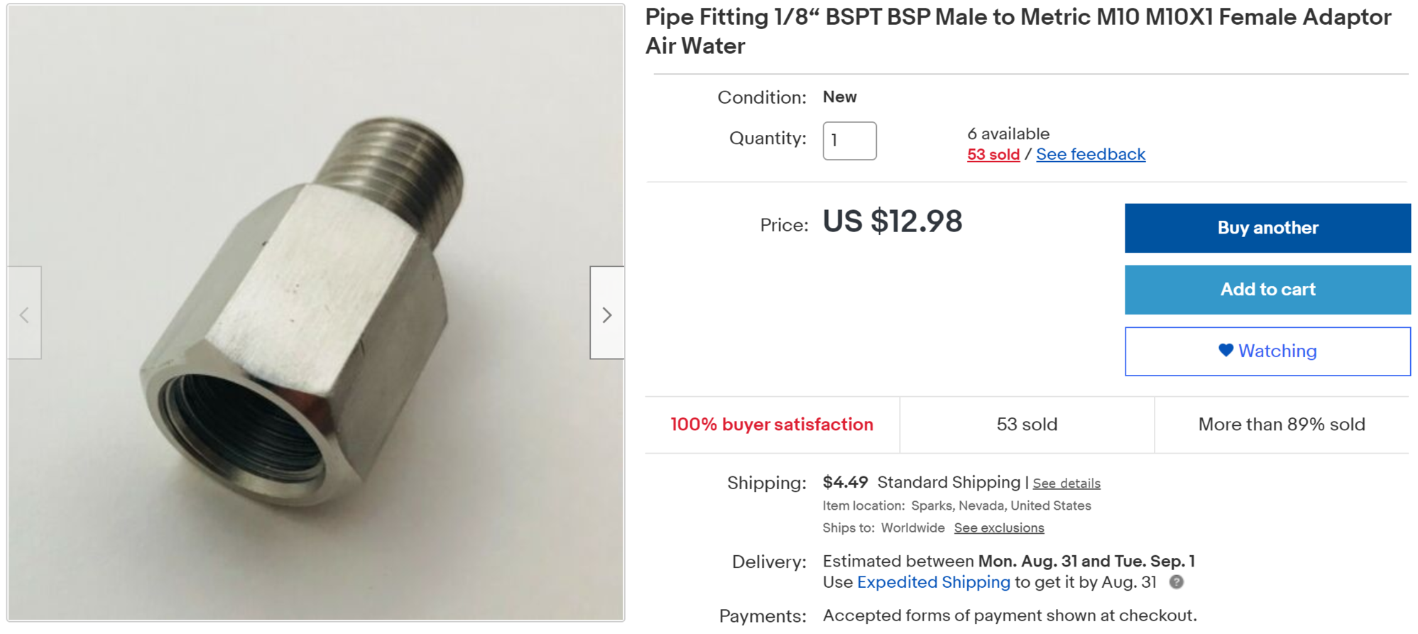

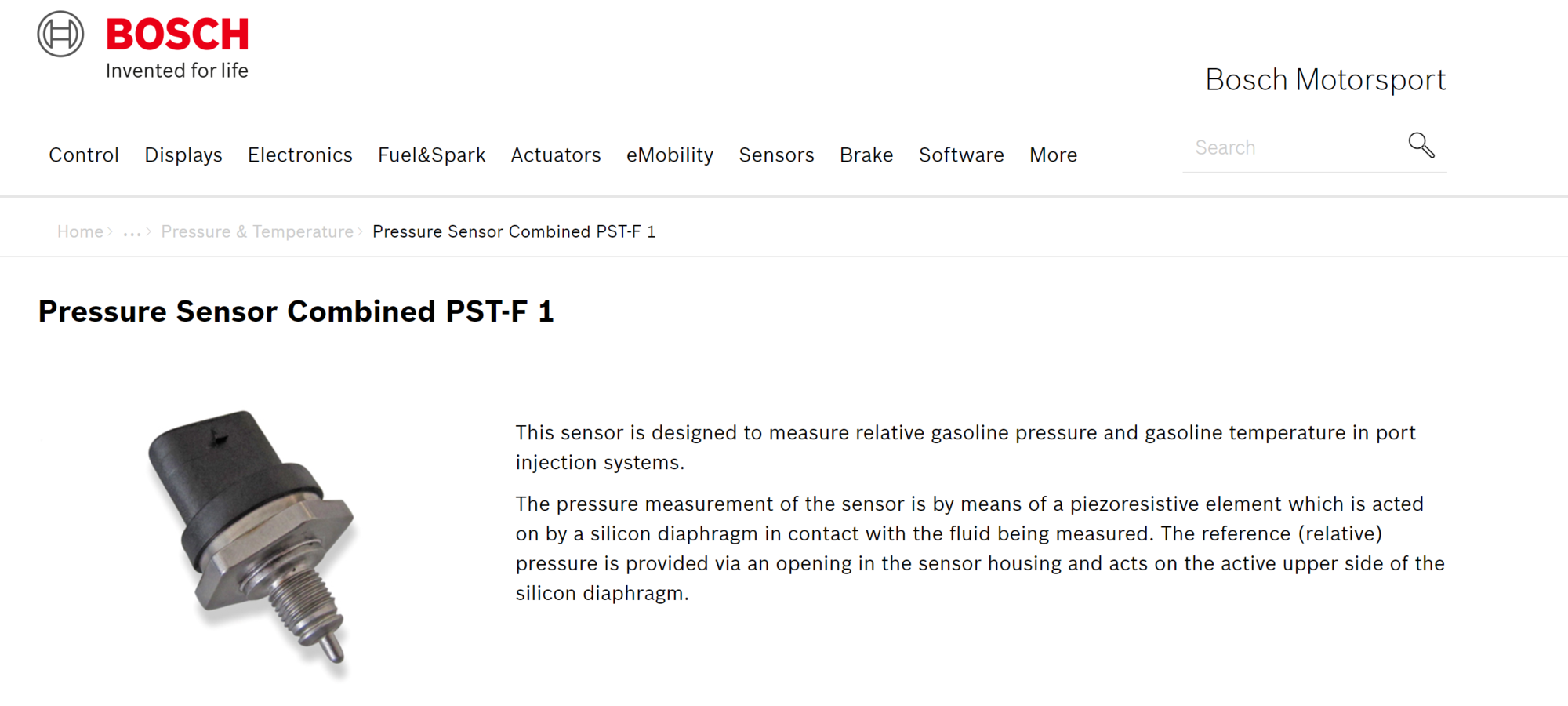

What exactly are you trying to measure the pressure and temperature of? If ti's fluids, I'm using this sensor for oil pressure & temp. Not cheap but works great:
Pressure Sensor Combined PST-F 1
and you'll need one of these to use it on your block:
https://www.ebay.com/itm/Pipe-Fittin...72.m2749.l2649
