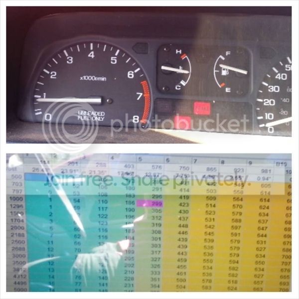

Okay i just swapped my ls head to a built ls head. I have it idling pretty good, but seems to have less vacuum. Is this normal? Sitting at 500ish mbar and at 800-900rpm.
Cam gears 0,0
Cant get igntion timing to advance to 16* with distributor fully advanced. It's more retarded atm.

Im using crome and idk if it can lock. I try to adjust ignition the original way earlier but cant get it to 16* with distributor advanced all the way and service connector jumped. I just ask a local tuner and he said try advancing the camgears. I'll give that a shot tomorrow

If you don't know how to lock it then how are you synchronizing ignition? Is the ignition output of the Ecu even 16*BTDC when you are lighting the mechanical timing? My guess is your big cams are pulling a low vacuum which is putting your idle region in an area with lower ignition advance and you are trying to sync your ignition at less than 16*. Whats your table ignition value at that cell in your screenshot? I bet its around 14*.
He said "in the program" and im not sure how to lock it in Crome, but i jumped the service connector to lock it in. And yes you are right about "your big cams are pulling a low vacuum which is putting your idle region in an area with lower ignition advance and you are trying to sync your ignition". Now that i thought about it i dont know if it's correct to adjust igntion timing to 16* degrees at that vacumm???
If it's idling about 12.87" of vacuum @ 800-900rpm. Would syncing it to 16* be correct? I was told i need to advanced the camgears to be able to sync it in at 16*

Solved the problem. The cams are supposed to idle around that vacuum/area because of aggressive cam lobe.
Muckman was correct. I was trying to adjust ignition timing at distributor first then set it in the program after. Wrong lol.....So i synch program to 16.5* then adjust at distributor and got it synch correctly, but distributor was advanced all the way. Either way it idle smoother....Thanks everyone.
