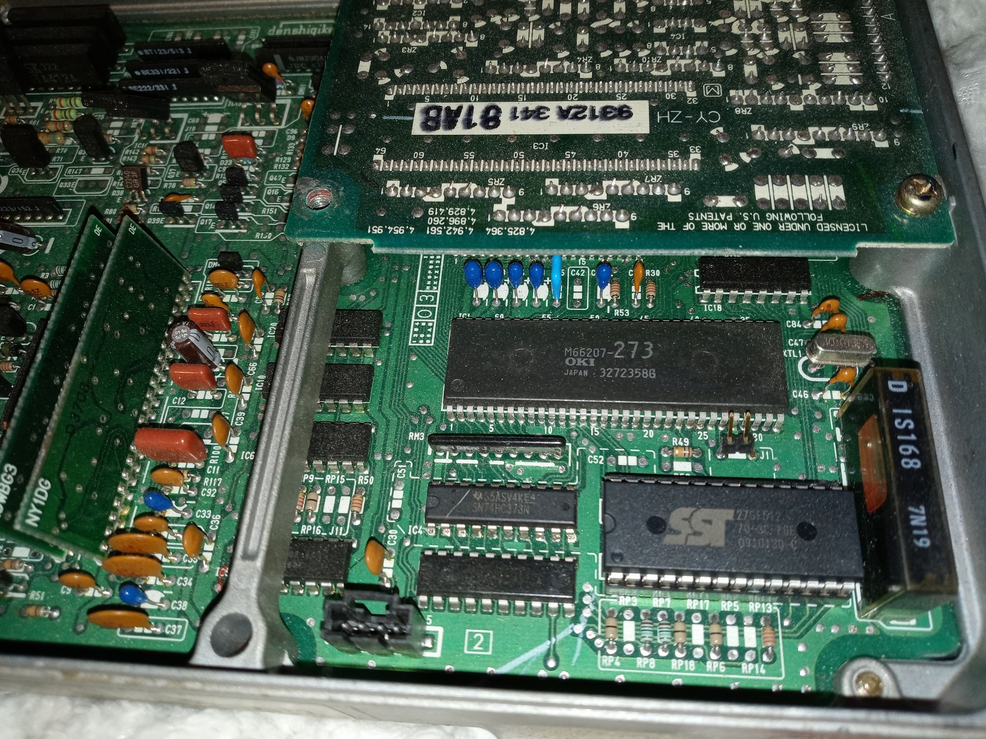

Hey Guys, Really New To The Chipping ECU But Do Have Some Knowledge. But I Have A Chipped P72 That Get Put Into Limp Mode When J1 Jumper Is Connected. I Recently Bought A New Chip Thinking That I Had A Bad Chip But Still Have The Same Problem. So Im Stuck Ive Checked All Sodering Points To See If Any Were Touching And Nothing But There Is One Part Of The EcU That Is In Question. Plz Help!!

Im Currently Using CROME Gold And I Have A SST 27SF512 Chip. I Use The Moates Burn2. I Looked Up Evrything On The ECU Just To Make Sure Everything Was There. And Its All Installed Correctly. I Will Have Another Reply With Pictures Of The ECU.

Okay Checksum Removed And Here Are The Pictures Of The ECU Hopefully The Quality Isnt Bad When I Post Them

I'll take a better look at those pictures when I get home tonight. One thing I have been doing lately with these older ECU's is replacing the capacitors. I think Moates or HRTuning used to sell a capacitor replacement kit. While you have it out looking at it, might be something to look into.
