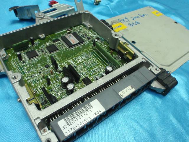

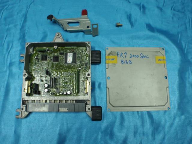

That's definitely not a spoon chip. that's a Knock-off Spoon Program onto a chip, in a USDM ECU.
Here's what they were. Plus, the ECUs were physically different. They were for EK9 B16B engines, not the B16A. KEIHIN ECUs are wider.
