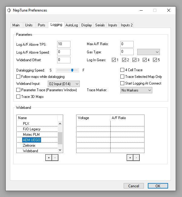

Good info guys! So Do you cut the wire from the ecu harness at d14 and connect that directly to the white wire from the wideband? What do you do with a26? Ground the wideband to it by splicing into it?
https://technet.ff-squad.com/wiring.obd1.htm
Not sure if Neptune was updated since this post but there is an AEM option now but it still didn't work.
edit: found it. This should be sticky https://www.hamotorsports.com/pages/...g-instructions
