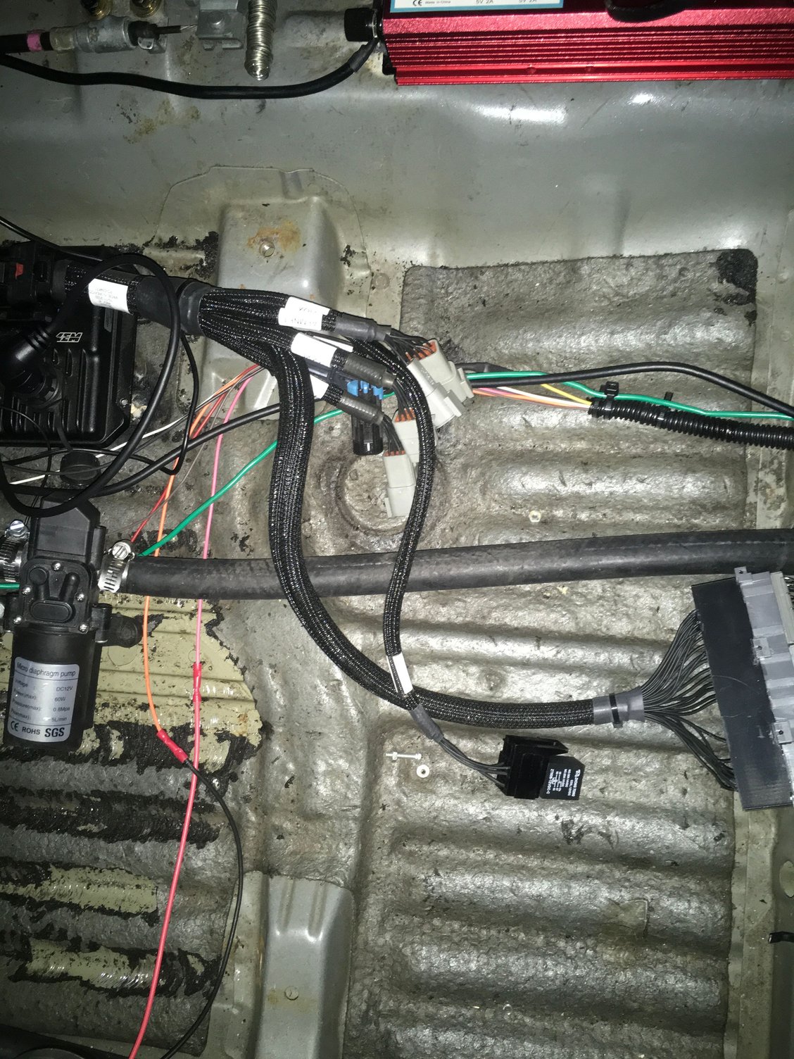

I have a s300 p28 that’s why I did cpr and wired it and then found out the v3 doesn’t support cam trigger how I wanted it too. I have the cpr already wired in ik aem already has drivers. I have it wired to the factory loom with the adapter to go to aem ecu. Why or how should that not work with the aem? Wouldn’t it already be adapted oof

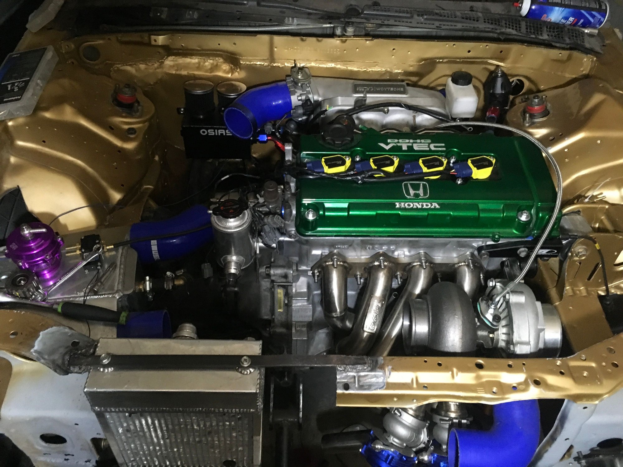

The AEM doesn't need any drivers, assuming you're still using OEM style coils as you have in your photo. It has ignition coil outputs. You can use only one of them if using a distributor or you use four of them for COP..
You need to bypass the CPR. There's no way to understand how you've integrated it into your loom without seeing pictures and a schematic, but it should be as easy as running the four coil output wires from the CPR connector straight to the appropriate coil output pins at the ECU. Then sell the CPR setup and get a little money back.

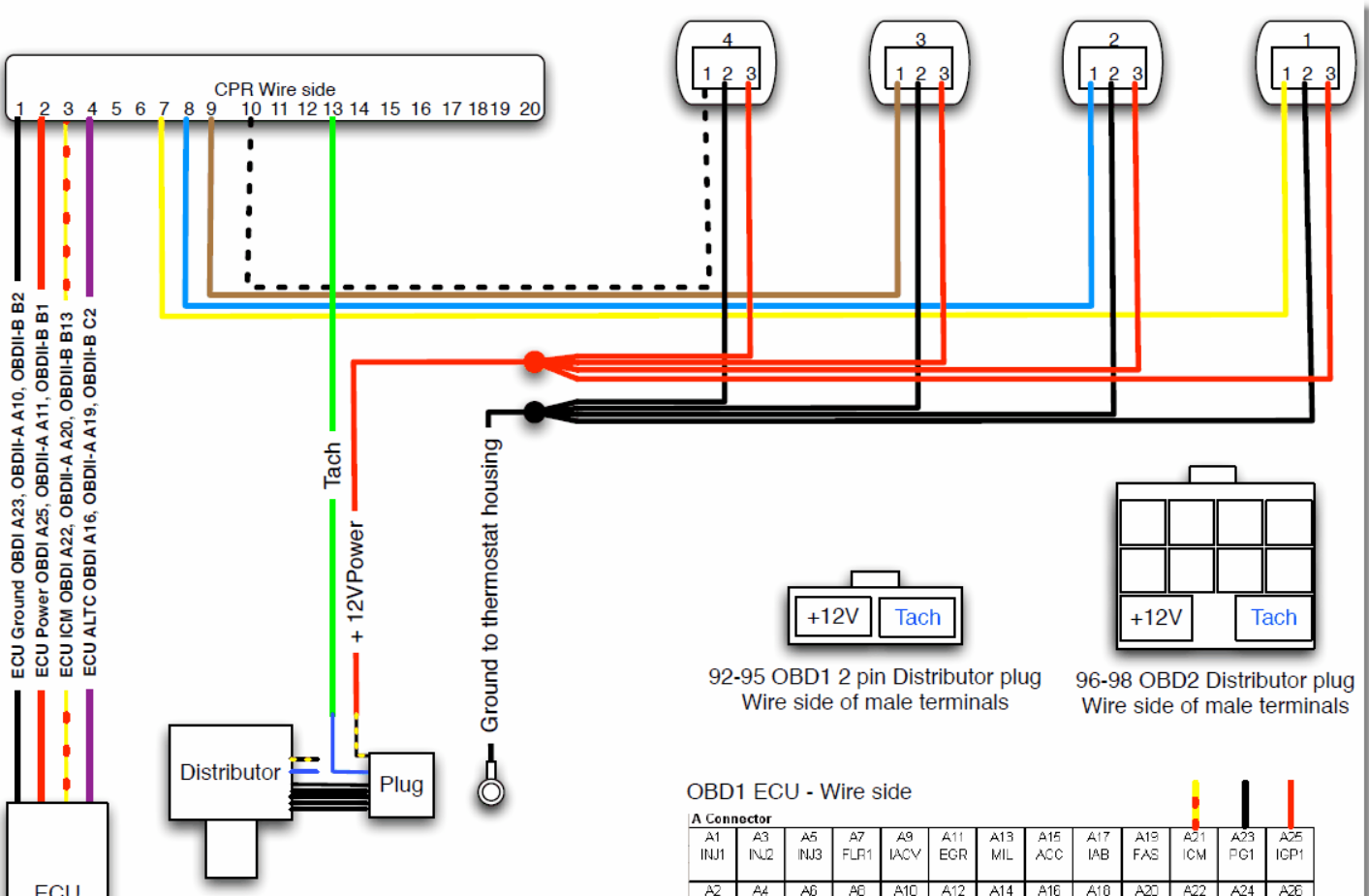

If you had the S300 and CPR working on your previous setup, bypassing it should be exactly as I described in my previous post. The coils will still get power and ground at the distributor and thermostat housing, respectively. All you need to do is remove the CPR unit and connect you four coil trigger wires (terminals 7-10 on the CPR plug) to the coil trigger outputs on the Infinity loom. Done and done, you don't have to rethink your entire build for it.

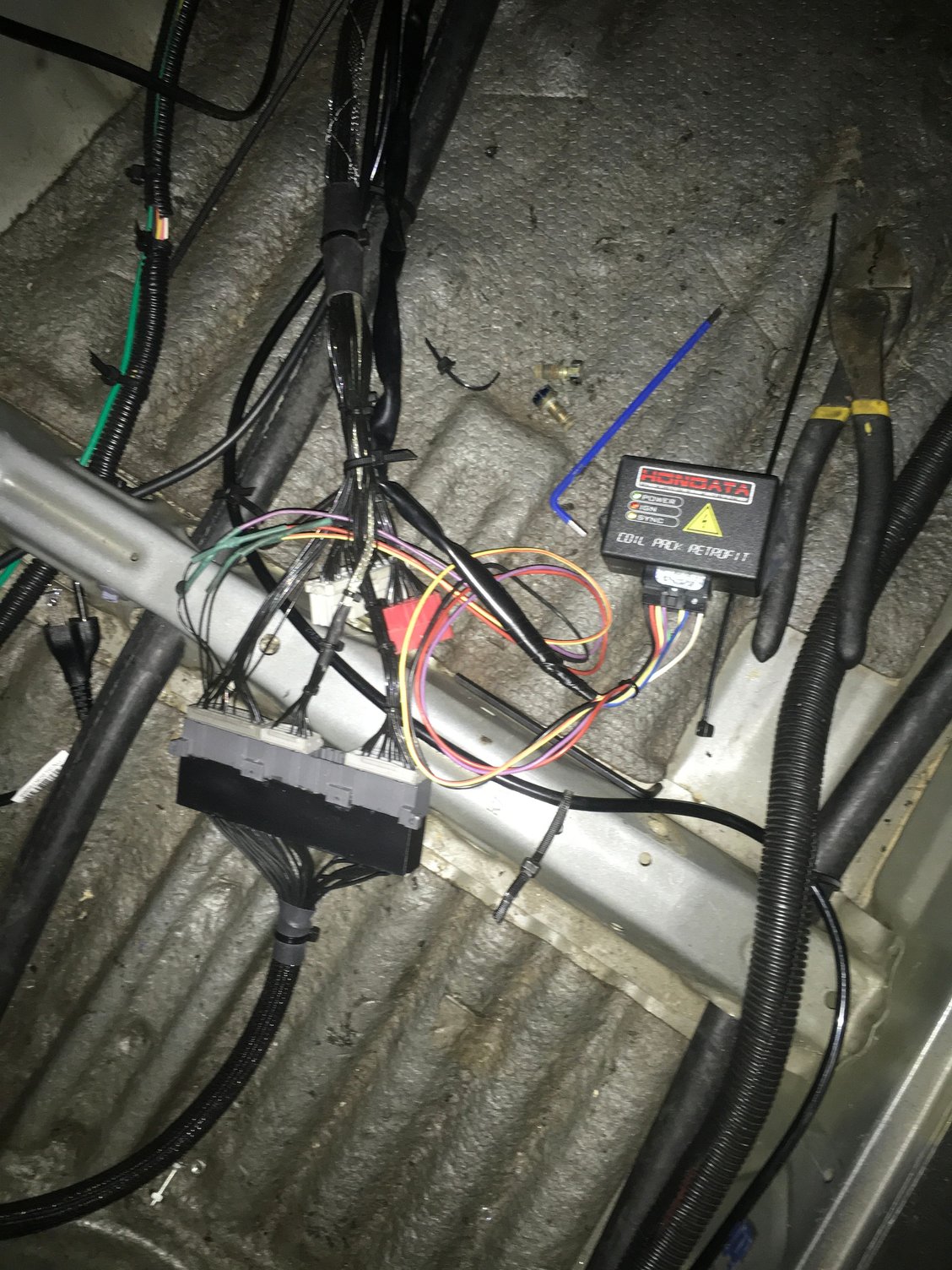

That’s how I have it wired? I’m confused.

Do you understand what the CPR does? Did you look at the diagram I posted above? If you take a few minutes to do that, you won’t be confused.
Remove CPR.
Remove the four wires that are currently headed toward your ecu from the back of the ecu connectors.
Remove the four wires that are headed into the CPR connector from the engine side of the loom. The whole CPR is now deleted.
Connect those four wires to whatever pins AEM say to connect them to, assuming they are pinned out on your a-dapta-kit there, assuming it is pinned out for that. If it’s not, you’ll have to get creative.

Yeah I’m not going to cut into the harness anymore everything has 0 miles on it never ran. Hondata said cpr only works with hondata s300. I think I’m confused cus it’s more splitting open wires that Im not comfortable doin I Will save for custom harness since I’m still going to do ckp and obd1 obviously has it in the distributor so that’s another thing I would have to splice in. Obd1 seemed the way when i started. Guess I was doin the impossible thanks old man for responding.
