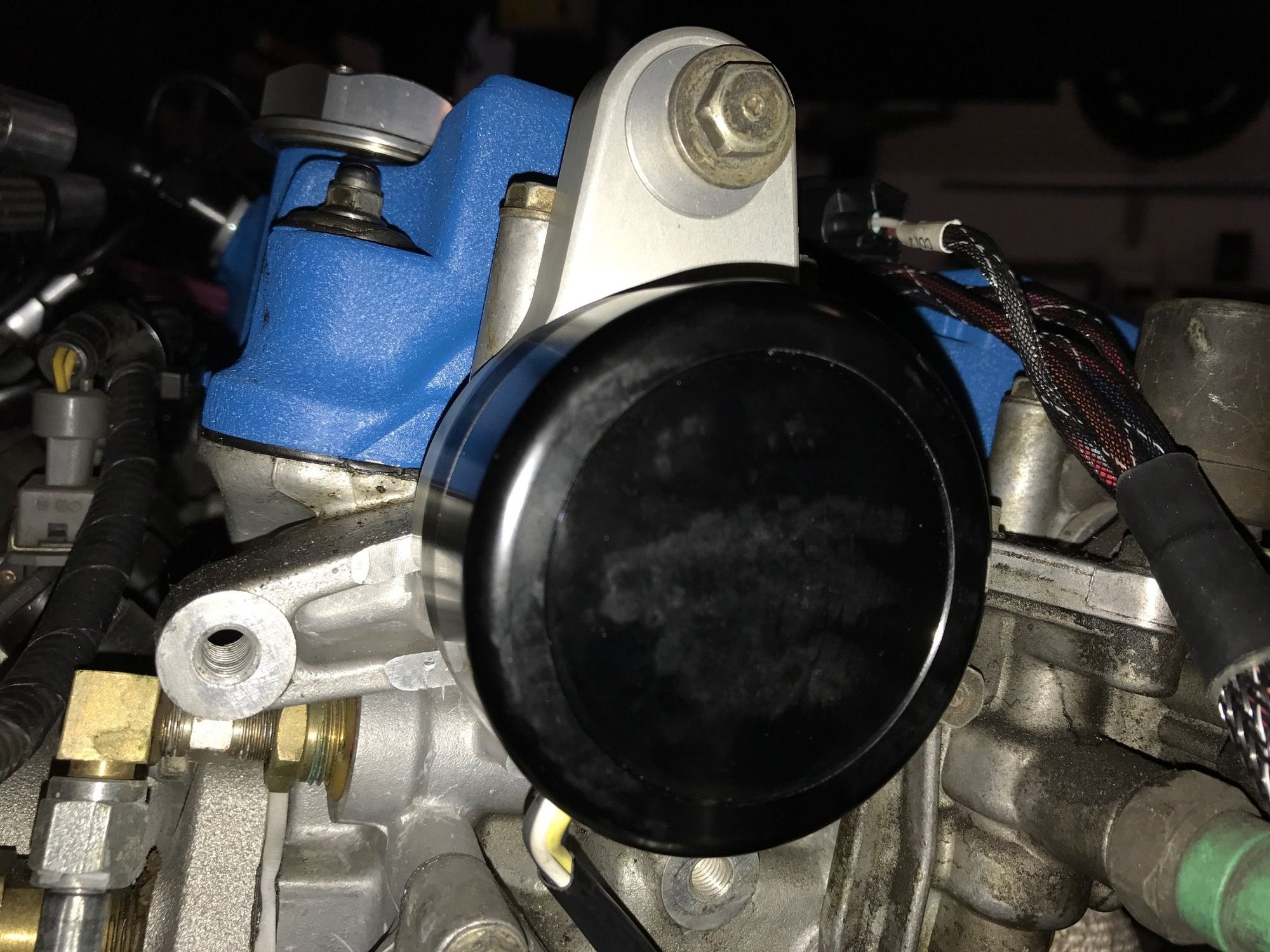

I did a full system check and found out that the plugs fired in the right order but they fired about 90 degrees to late! Because I could not find 1 setting wrong I changed the cam follower 180 degrees and mounted the puck at the top mounting instead of the side mounting. The car started!

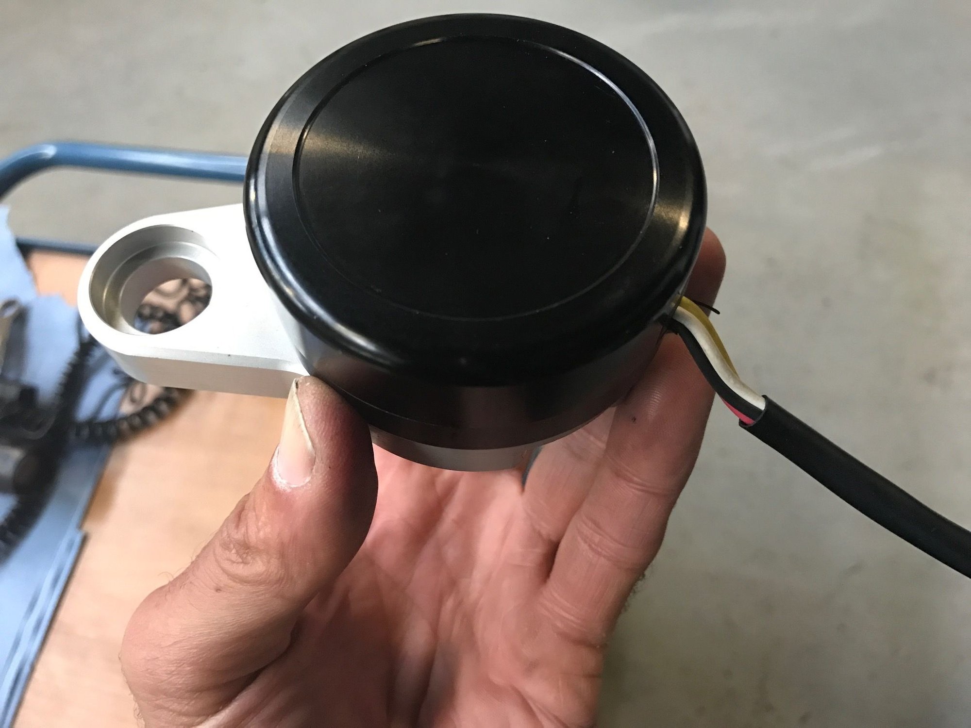

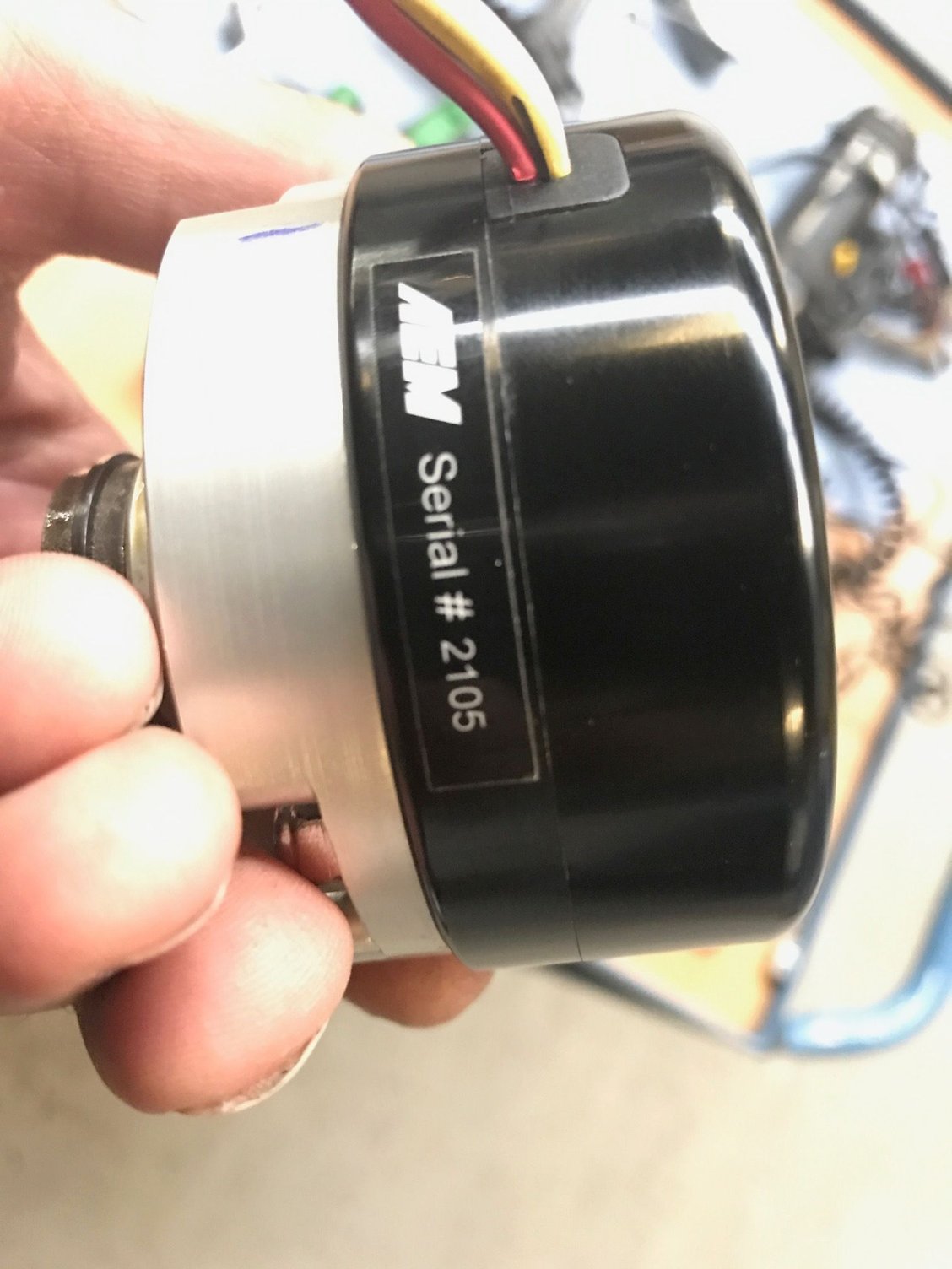

1 thing I noticed is that the wires from the puck are coming out of it on a strange location.
This is a picture from the AEM manual and as you can see the wires come out at the bottom of the puck. In the other picture you can see that the wires come out at a different location.
The serial number is right, the part number is for a B series but it looks like this puck is for a D series??
I have tried to get on the AEM forum but confirmation emails are not being mailed back to me. And the series 1 EMS is not supported anymore.... :-(
Strange location for the wires to come out...

Mount the EPM on the back bolt. Though this should not make a difference when you sync it. Some timing drift is normal, you need to rev it slow and smooth when checking for drift.
