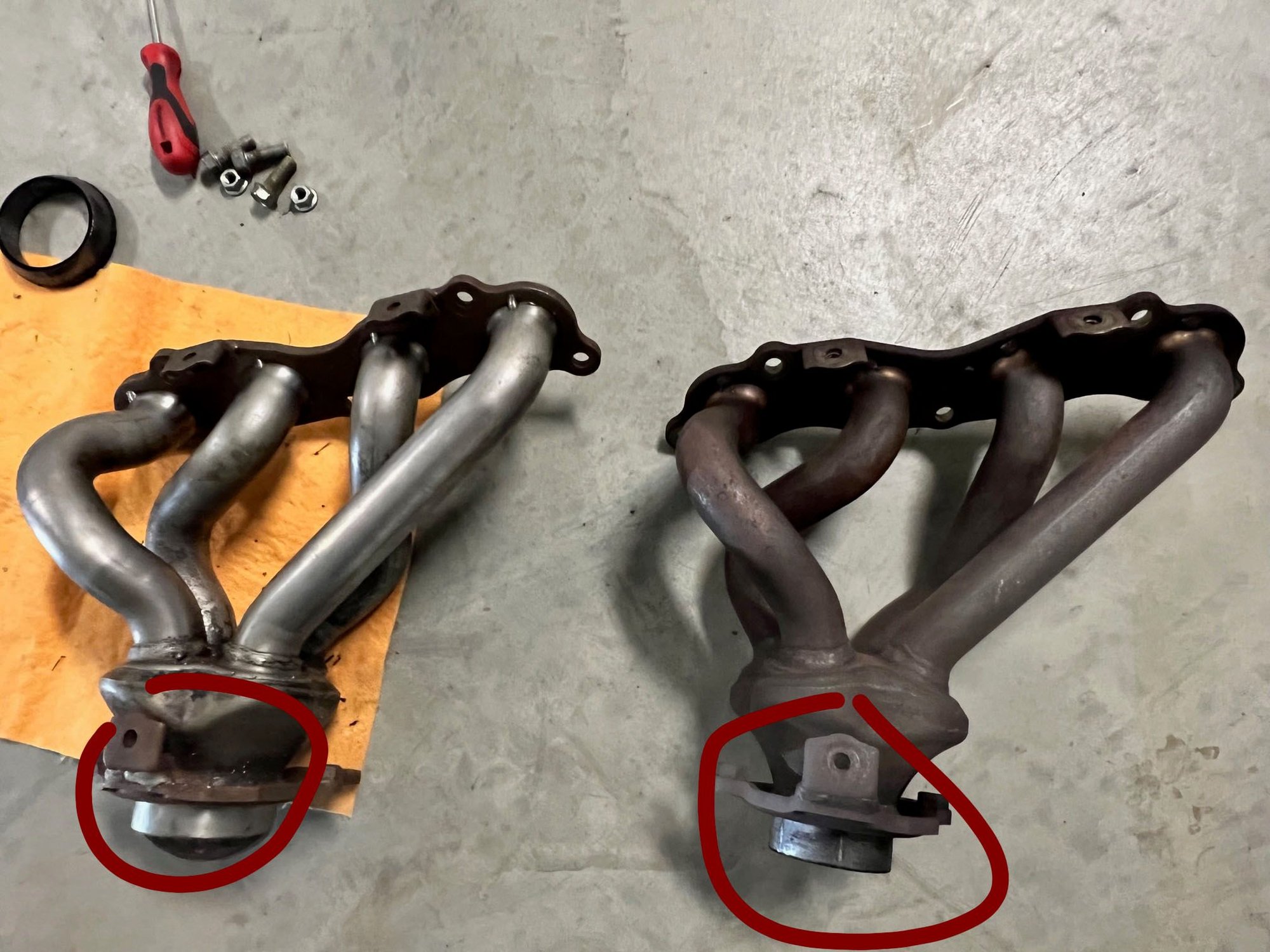

*K20z3 6-speed + LSD transmission swap
*FD2 Type-R flywheel + K20z3 friction disc + K20z3 pressure plate swap

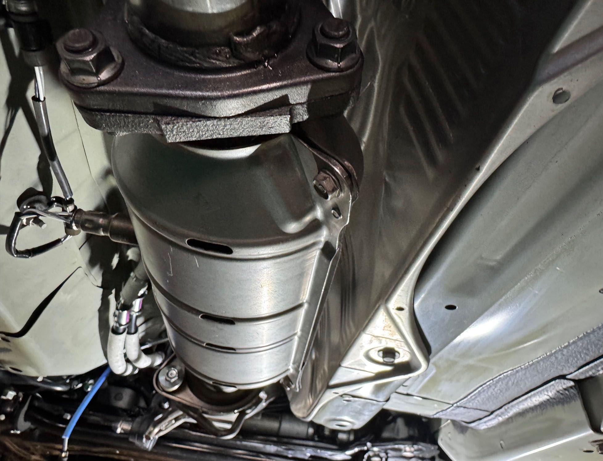

*K20z3 exhaust header swap + K20z3 catalytic converter swap

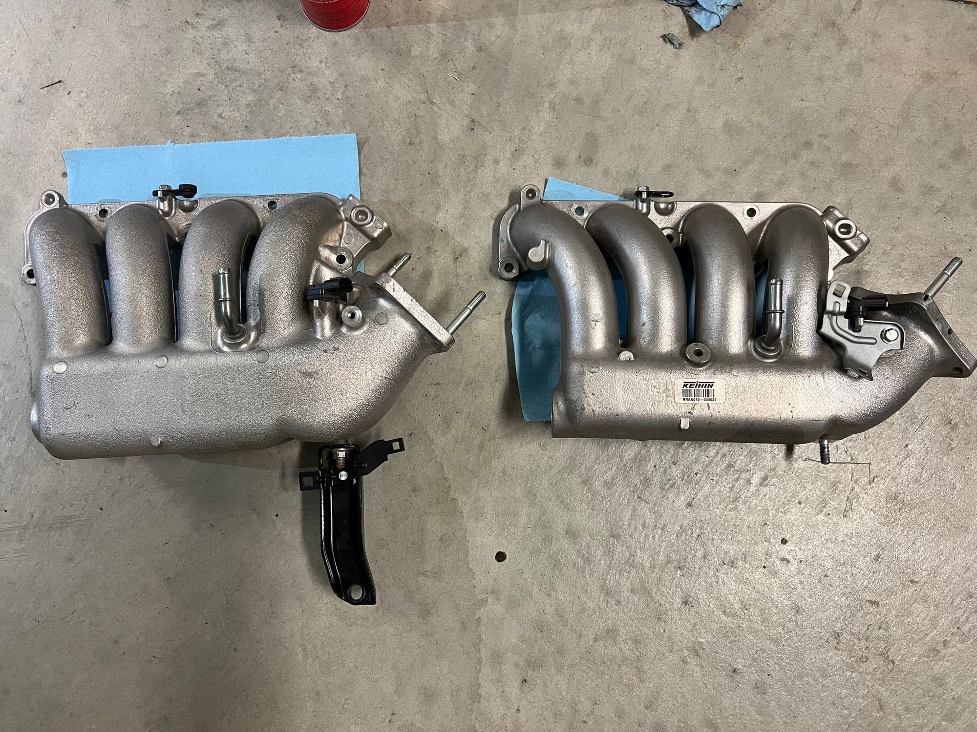

*most importantly, an Acura TSX intake manifold RBB.
I had to research the intake manifold one for weeks because I came to the conclusion that going RBC (civic si) or type R (RRC) manifold would be a waste since again I only redline to 6800. The TSX manifold gave me tons of low torque which when swapping to 16 inch RSX Type-S wheels made me finally chirp 1st, 2nd and 3rd to my surprise.
*I tried considering maybe a J35 throttle body but also found out it was a waste of gas? I'm not sure on that one yet.

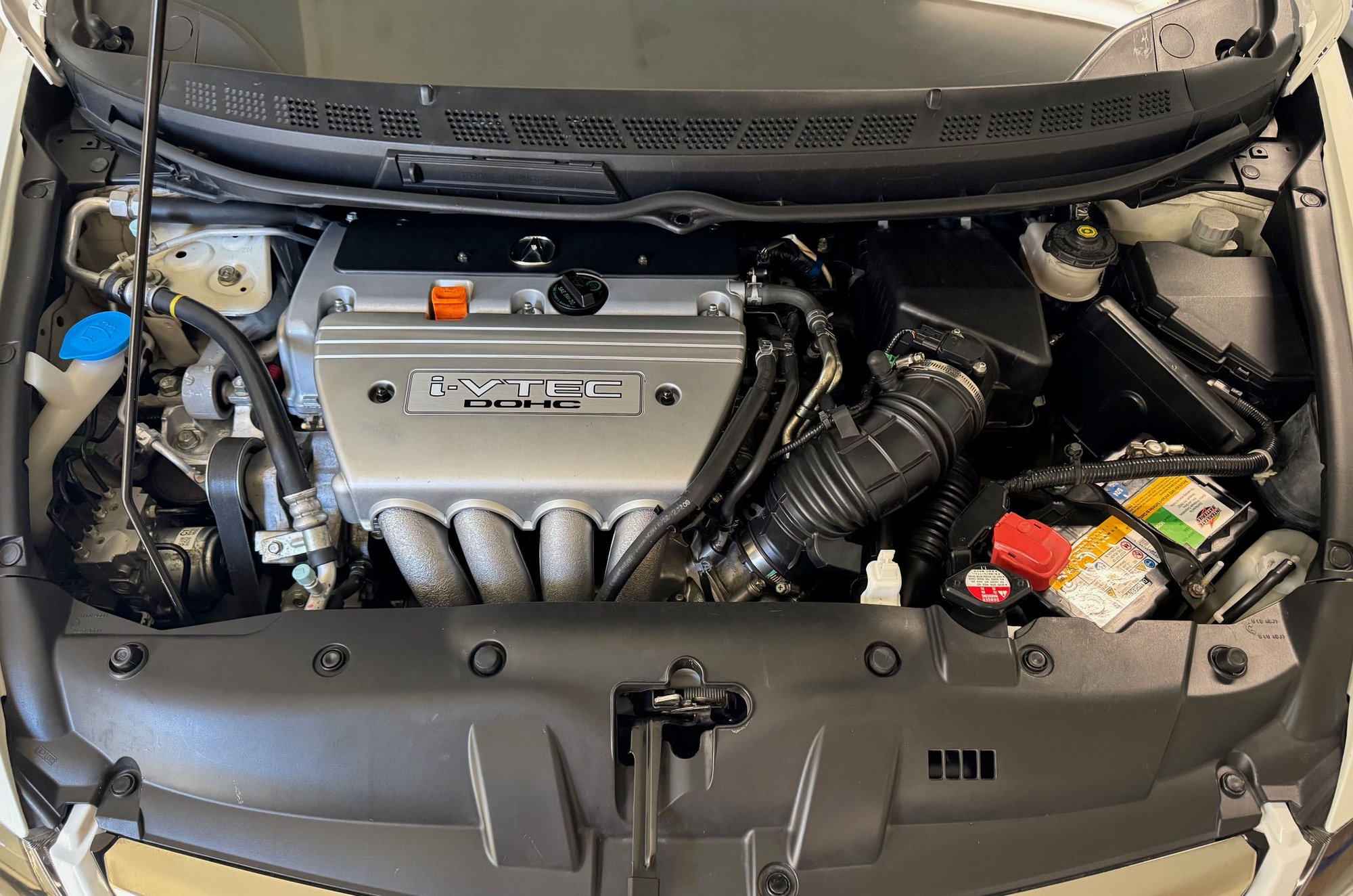

Cleanest engine bay I could make

I might consider the K24A2. This is the TSX RBB intake manifold I swapped out for. I got this information from the Honda Element Club where they would often do this modification on their engines. Look how much beefier the plenum is!
Here's another head scratcher I was theorizing. Japanese automatic FD vehicles has the same part number as the header I have on my CSX on right. It looks nearly identical to the K20z3 header on left. But at the end there's no separator as you see on the bottom. I tried to ask in 8th gen forum if the Si header was sort of like a 4-2-1 compared to 4-2 without that 'half-moon' thing at the end. Turns out measuring the circumference of the runners was a difference of 12cm and 11cm respectively. But yet, the shape is exactly the same. Even the exhaust manifold shield cover is the same part number! And as a bonus the CSX Type-S also uses the same header part as the Si.
Anyway, I've got a lot more research to do. Thank you for the helpful tips

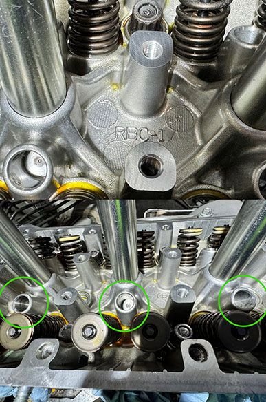

No, k20z2 is not the crappiest engine. It's actually pretty descent from the point of gradual upgrade. What does this mean:
It's RBC head (like k20z3) which means it already has the castings for the lost motion assemblies. Essentially it is a k20z3 running with a k20a3 rocker assembly.
Knowing this you can put FN2 camshafts (and rocker assembly) with VTC 50, flash it and get around 180hp/185Nm (considering the rest is stock). Then you do headers, intake, tb, change block to k24 with higher compression etc etc. With your already existing upgrades.. well, I'd love to see what can you get.

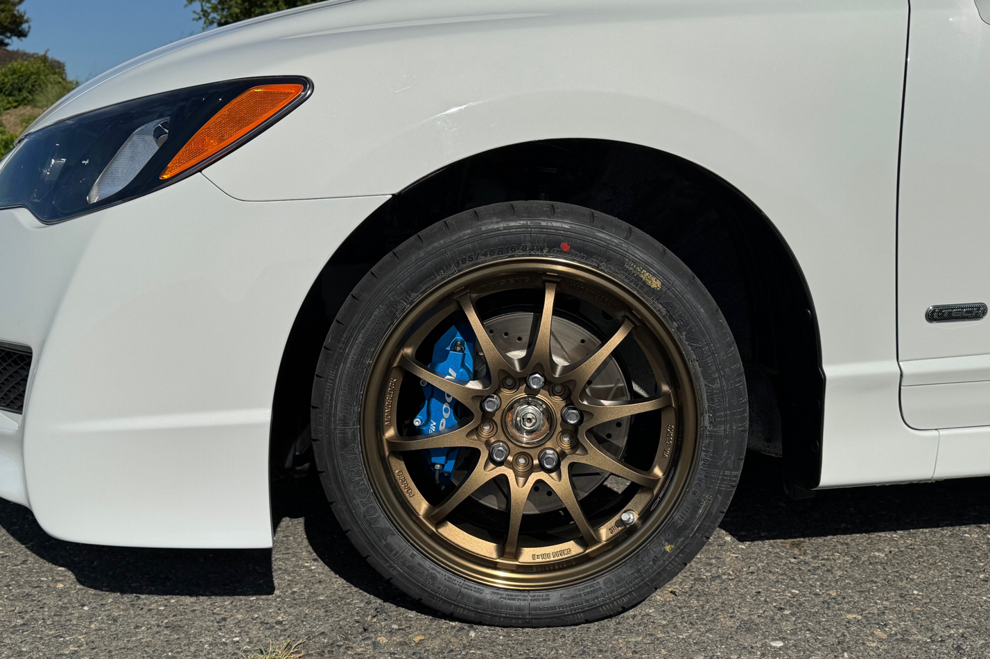

Sorry for the loooong *** delay (also posted in the wrong reply 🤦‍♂️). I finished everything. And @JRcivic1 was right. I got real VTEC by using 2008 TSX camshafts + RBC VTC 50 intake camgear. I also had to source an RBB solenoid and the VTC spool valve assembly. Also I used a CSX-Type-S ECU (exact same as a Civic Si) ECU and an Si engine harness and a FlashPro.
I'll try to keep it as short as possible since there's a ton I did within the 2 years and some really interesting finds along the way. It turns out the k20z2 cylinder head for the Canadian only 2006-2011 Acura CSX (non Type-S) is the exact RBC-1 cylinder head as an 8th gen Civic Si cylinder head and CSX type-S cylinder head. (Only thing missing are the entire upgraded valve trains + upgraded assembly shafts/rockers + lost motion springs. In fact, the k20z2 has the castings for the lost motion springs except no springs! There was a mention of this from a post decades ago on some guy trying to upgrade his automatic Asian FD civic to an FD2 before he stopped updating. Here is a photo I took of my cylinder head as proof:
It turns out the stock assembly shafts, springs, plus the camshafts are the EXACT same part # as the k20a3 RSX base.
I don't even know where to begin next because I made so many modifications. But along the way, I also upgraded the valve springs, retainers, keepers, seats, assembly shaft, assembly rockers, valve adjustments. Took out the EGR assembly and capped it with an OEM plate. Had to change knock sensor to match the fittings from the Si engine harness. I ported an RBB intake manifold, and also port matched it to the fuel plenum and to the TSX throttle body (i know i know, RBC or RRC intake is milles better). But I'll explain later.

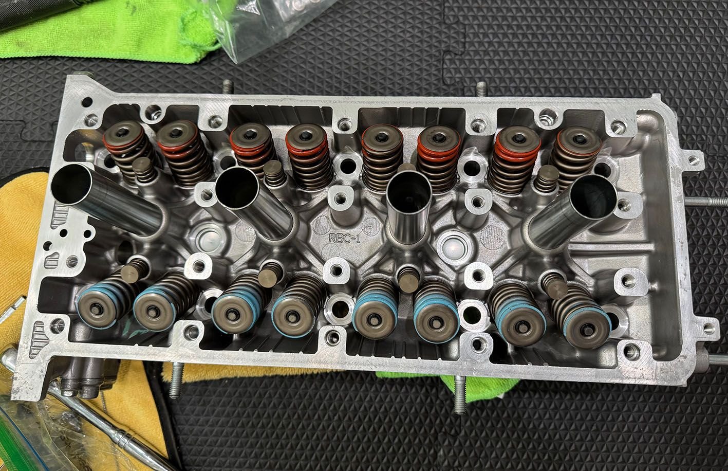

I finally had the confidence to pull my cylinder head and replace all the springs to an FD2. I think FD2 springs have the same part # as Civic Si.
I also did a light pocket port. How did I do this? Another long story, but in a nutshell I tried to port an RBB3 TSX head in 2024 and completely F*cked it up when attempting to remove the valve stems and then re-installing new valve stems. All that re-drilling and honing what a waste of 4 months and money. But I learned so much from that experience.
I also ended up with an genuine FD2 transmission (crazy story on how I ended up with this), also ended up with a complete FD2 exhaust system that perfectly fit with an FD5 chassis. (fd2 exhaust header + fd2 catalytic converter + fd2 pipe A + fd2 pipe B + fd2 exhaust muffler).
Then I got FD2 control arms, FD2 RRC crank pulley, using the same FD2 flywheel, clutch plate, and pressure plate from earlier, FD2 airbox and tube + resonator, FD2 fuel injectors. And then I finished it off with the smaller twin-block spoon calipers as it fit the stock brake discs! And got CE28N wheels to lighten everything up even more.
So now it really hauls *** throughout the power band while staying quietly OEM. But I was having the longest problem with FlashPro because I just didn't know how to use it. After increasing it to 7600rpm I was later told I could safely go up to 8000 but I must have a proper tune. The question is is it safe? Well some say it is, some say no. There aren't any oil squirters down there, (I haven't personally checked) But I heard you don't need it, some say you do... some folks use the RSX base block with missing squirters etc. Anyway with a little help here and there and by reading as much as I could research I'm almost done with the fuel tuning using MAP tuning. And instead of trying to rice it out like I used to do with my other Hondas/Acuras in my younger days, I decided to keep it 100% sleeper except for the lighter wheels and brake calipers. I love how unassuming my sedan looks, until I floor it.

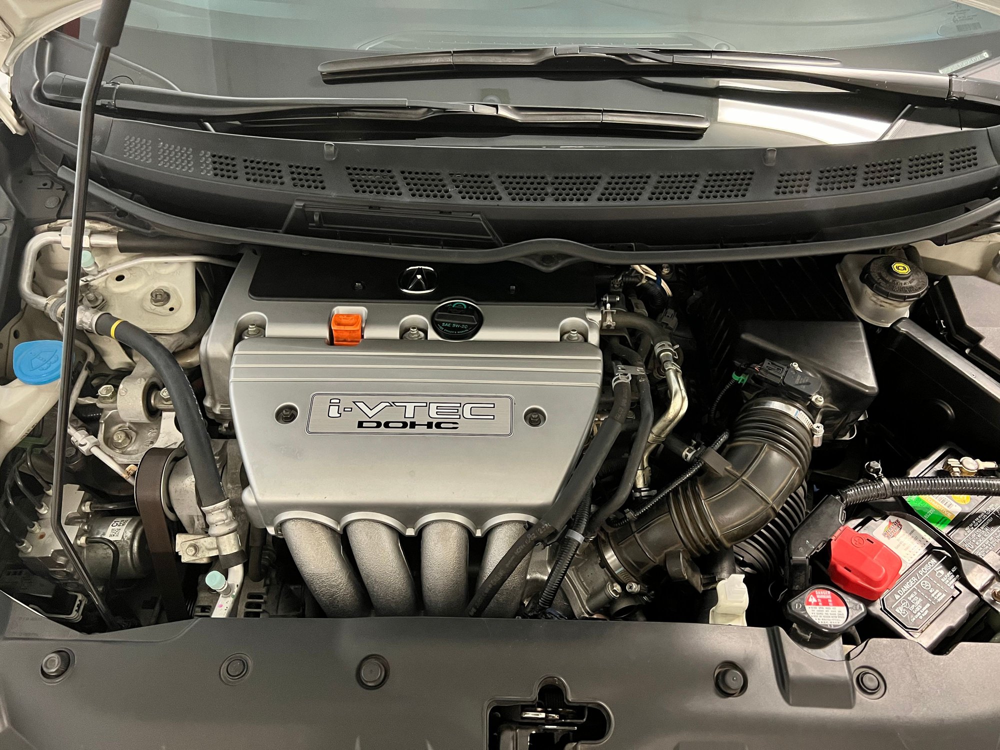

Engine bay.
