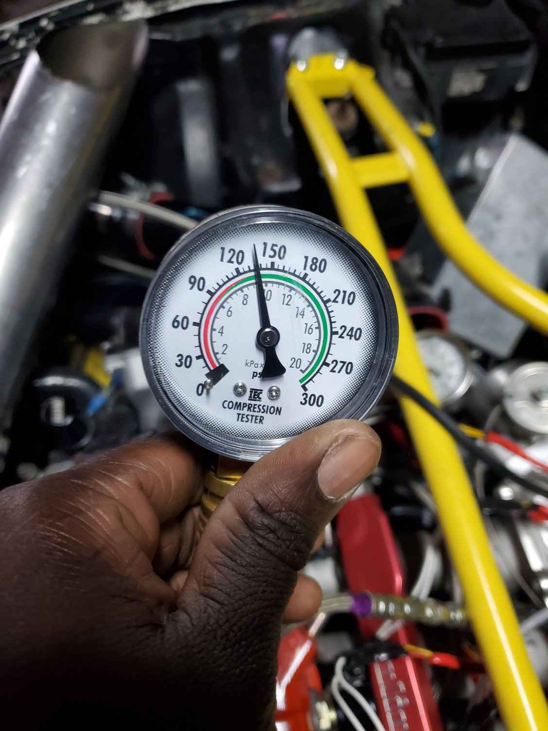

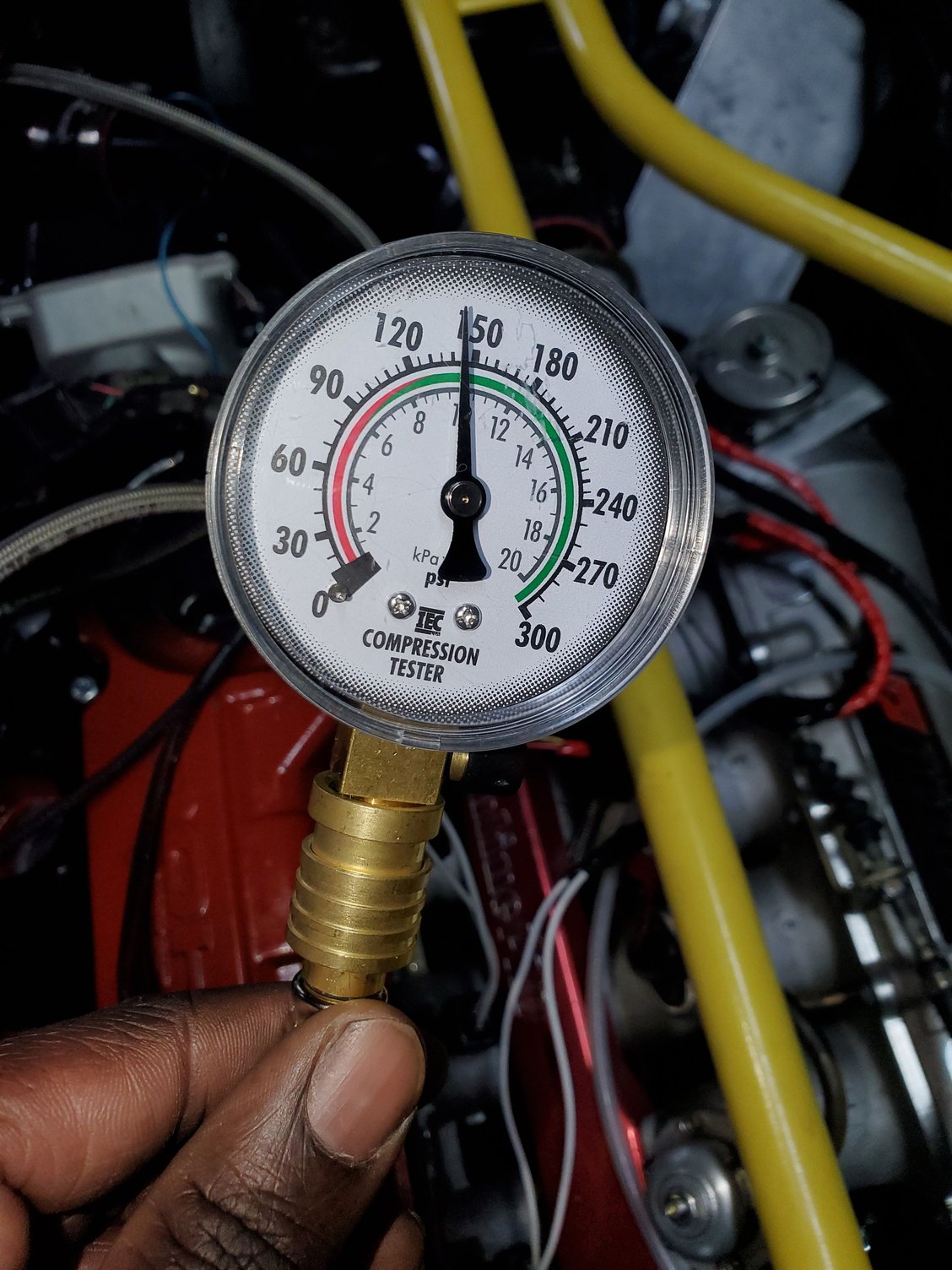

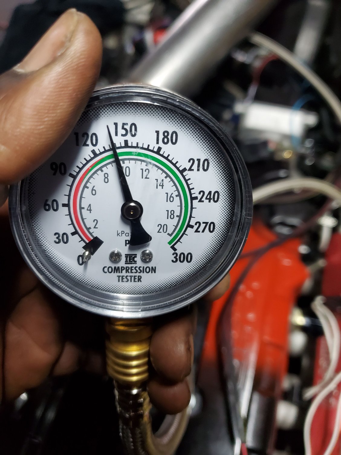

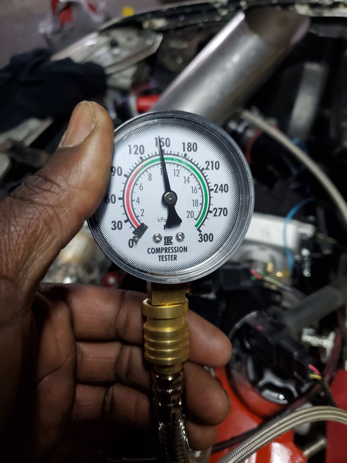

Those cam gears had seen better days so i ordered a new timing belt, newer cam gears, put the car back together and timed it to the best of my ability. Friend told me to do a compression test so I did. Granted this was when it was cold
and here we are today.. got the battery charging now. What would you do next? See if it fires up? Drop the oil pan? I can turn the motor over by hand. I'm new to this mechanical stuff I used to get in and drive but im trying my hardest to learn to work on cars and stop bothering my friend so much. Thanks in advance. Any info will help.

Depending on how far the mechanical timing was out will determine a lot.
A leak down might be a good test to do to be sure the combustion chambers are still sealing. If they are and you have 20% loss or less, I would try and fire it up and see if it sounds normal.
You would have to seriously detonate to bend a rod, it's more likely you bent a valve. Even though a bent rod is possible.
