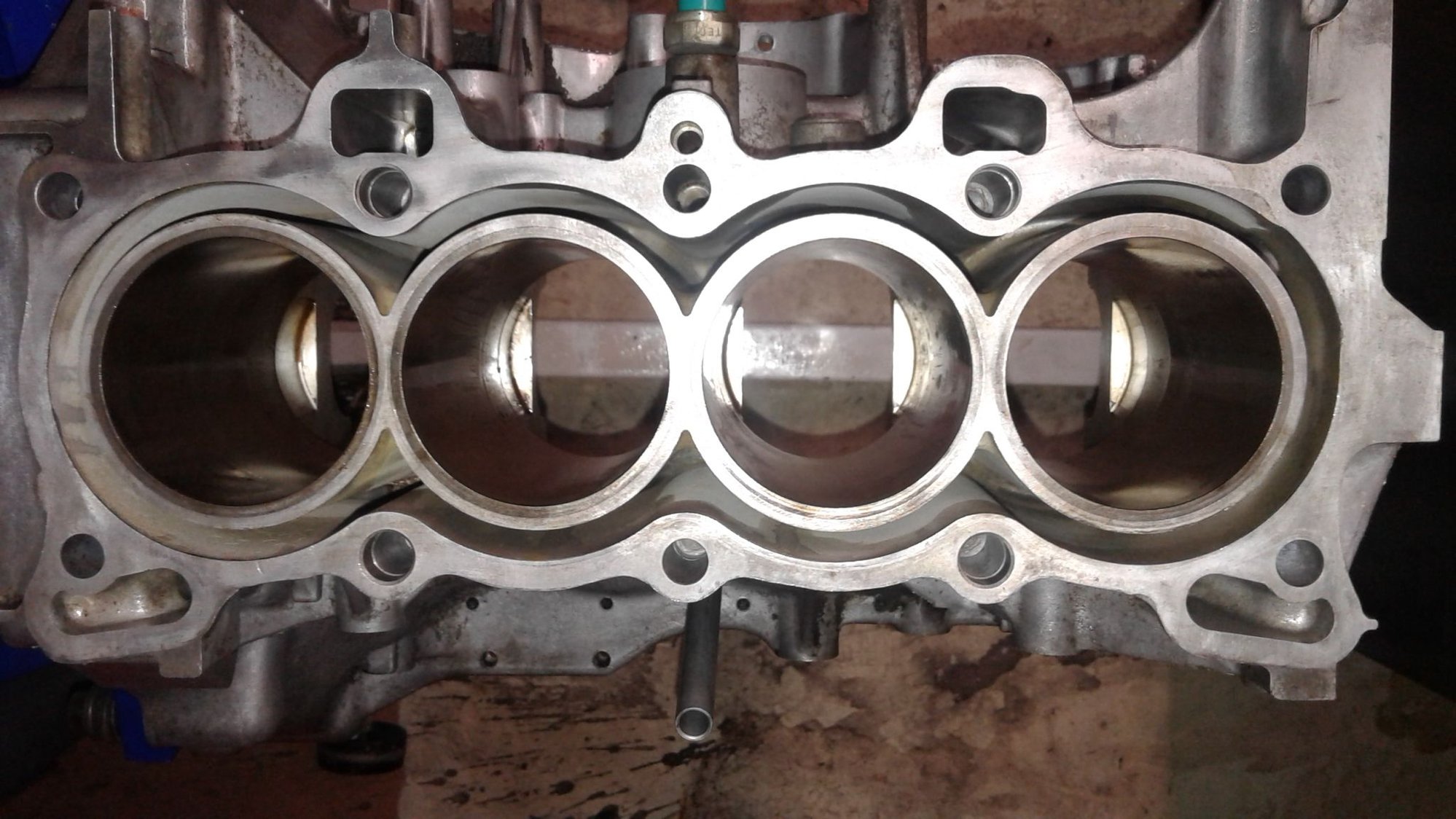

my buddy gave up on his d series project and went on to a b16. I was luvky enought to inherit the project but i have never rebuild an engine before so I'm asking for help and a push in the right direction as to what the hell I'm supposed to do. As you can see is in 101 pieces so I can not know where to start any suggestions?

Do you have a factory service manual?
From that you will learn the tools you need to measure everything to select the correct bearings etc etc.
Expect to drop half a grand or better on tools alone.

yes sir i do have service manual and some of the tools required but at this point would it be better to take it to a machine shop?

That is entirely up to you. Do you want to rebuild engines? If you do, the investment into the micrometers and bore gauges is worth it.
If you don't want to learn that aspect, then have the machine shop do the whole thing. The cost is likely to be the same, the difference is what you can do later on down the road.

Like what TomCat is already saying, the only real benefit for you to rebuild that engine yourself is for the learning experience. It'd be perfect for that.
Otherwise, rebuilding that engine is probably pointless, even if you paid a shop to do it. I doubt it would cost much more to just purchase a (good) used D series longblock, I know HMO has full D series longblocks even WITH all of the sensors/accessories for $600->$900. For the longlbock alone I'm sure you could find good ones in the $400->$600 range depending on the exact model you're looking for.

ive been tinkering with hondas for a few years now never really got into doing the internals or cylinder head always wanted to learn it but never really got into it ...untill now so tomcat was right i read the service manual religiously like it was a bible dropped about 550 to 600 on just tools alone ..now just working on parts found a few decently priced rebuild kits on ebay....i figure its worth it at least this way ill the tools to do this sort of thing for as ling as i want versus paying someone else the sane money to do it for me one time....ill lodt up some pics once things starts moving along ....
