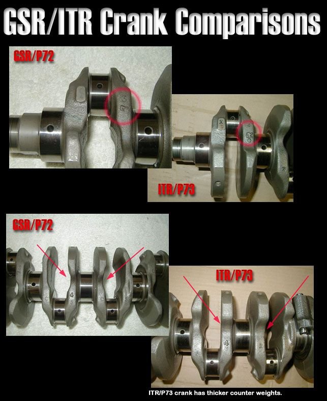

Default Re: Help identify this crankshaft
These are from an older ht post. Maybe these can help you reference it.
Its a gsr. Here is another ht post where it shows the same c3 marking.

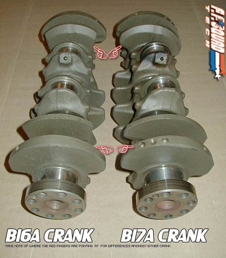

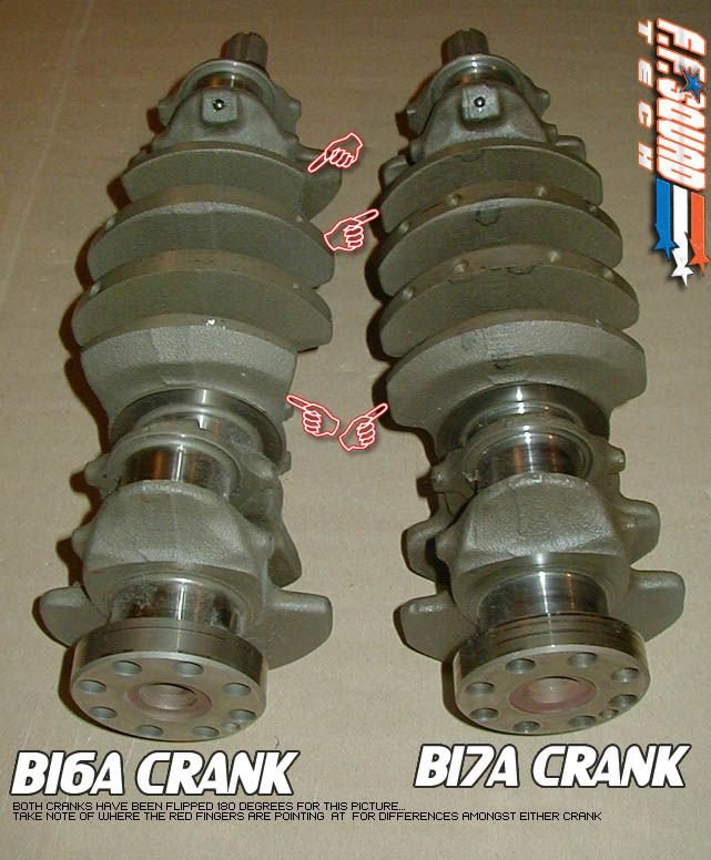

Forget the markings... some of that is similar because the stamped letters and numbers are for bearing color identification and NOT crankshaft identification. The obvious identifying trait here is the counterweighting... the second, third, sixth and seventh counterweight are bobbed. This matches the picture first posted by the OP marked as "B16A". The GSR crank only has bobbed counterweights at position 3 and 6. Also, the trained eye will see that the rod journals are wider than the B18C1/5 journals... and they overlap the main journal more meaning that the inner edge of the rod journal is closer to the crank centerline.
Compare with pictures in second post, or post up pictures with the same angles that post used, we cannot see the the parts in question with the pictures you have provided
