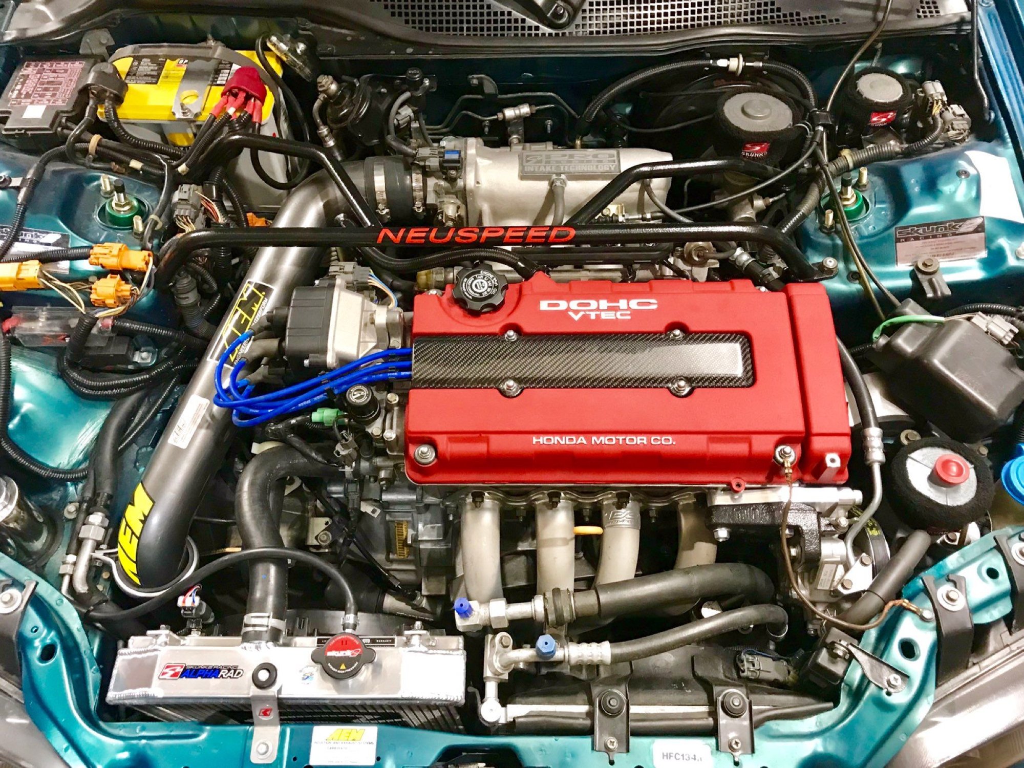

Some quick details, 95ej1 w/ b18c1 swapped in. I completed the swap about year ago and it's been driving incredible ever since! Some photos of my work attached. About 1k miles ago I dropped in some Skunk2 Tuner 1 cams. Here's the relevant parts for this post:
