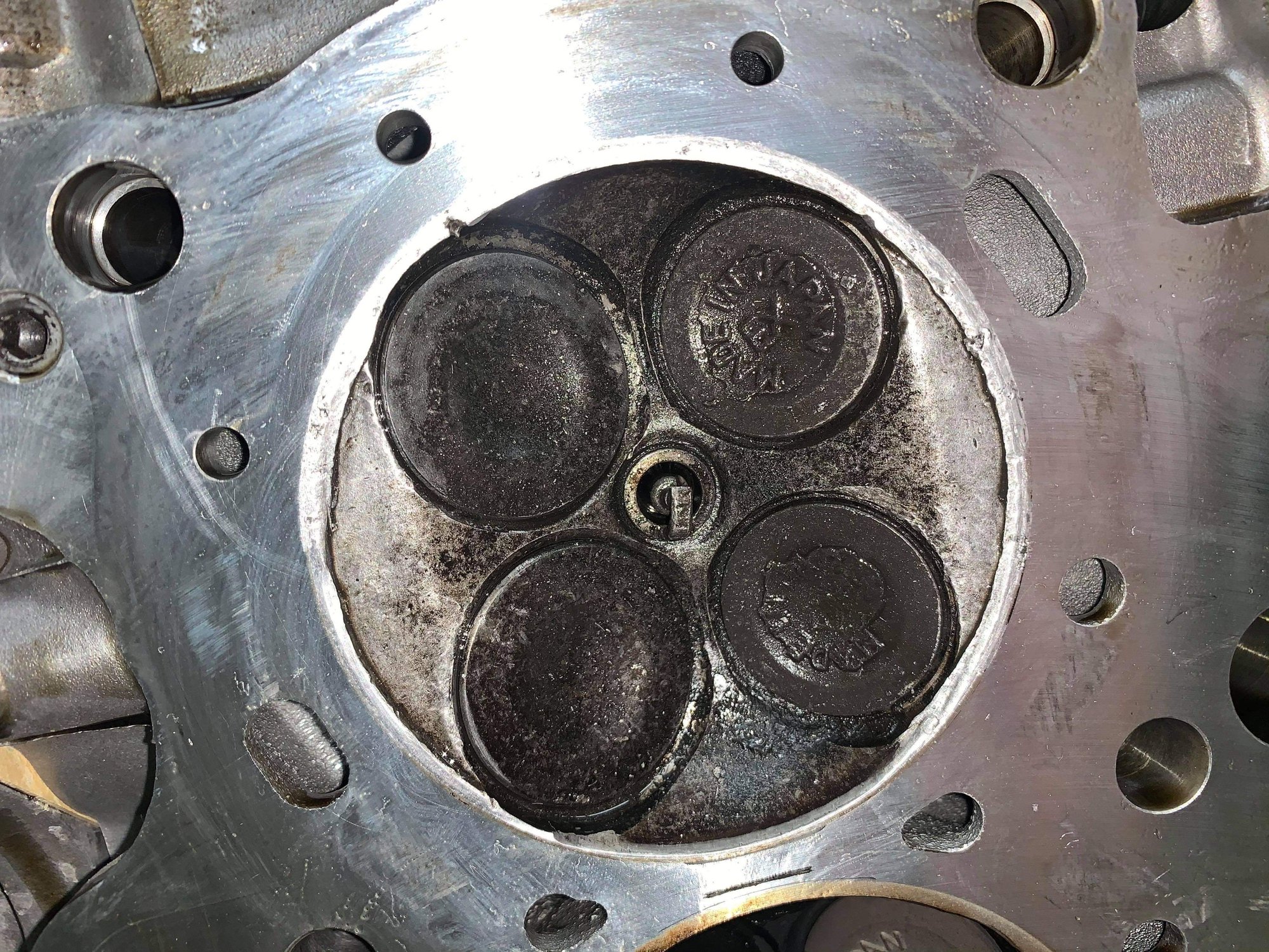

Can this be fixed with resurfacing?

Cylinder 4 damage

That depends on how deep the damage is to the perimeter of the combustion chamber. It appears that a piston hit the head face... and a big one at that. The best fix is likely to be to have it welded back up and re-surfaced to get the quench area back to original in that combustion chamber.
