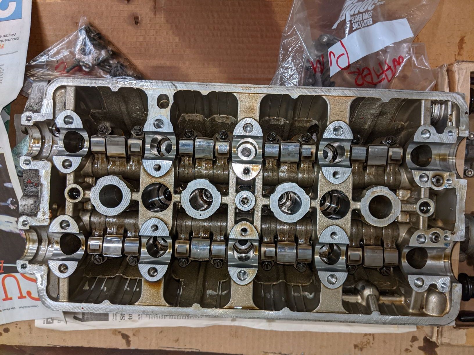

I did buy the swap. The head looked really clean under the valve cover and the markings all appear to be correct. There is some green paint behind the distributor so I believe it's an original head. The serial number is still on the transmission but I'm not sure if I can look that up anywhere, I'm going to search and see what I can find. I got it on the stand today but the stand is kind of sketchy so a buddy is bringing over one of his good stands for me tomorrow. I'll swap it over tomorrow and then start tearing down this week.

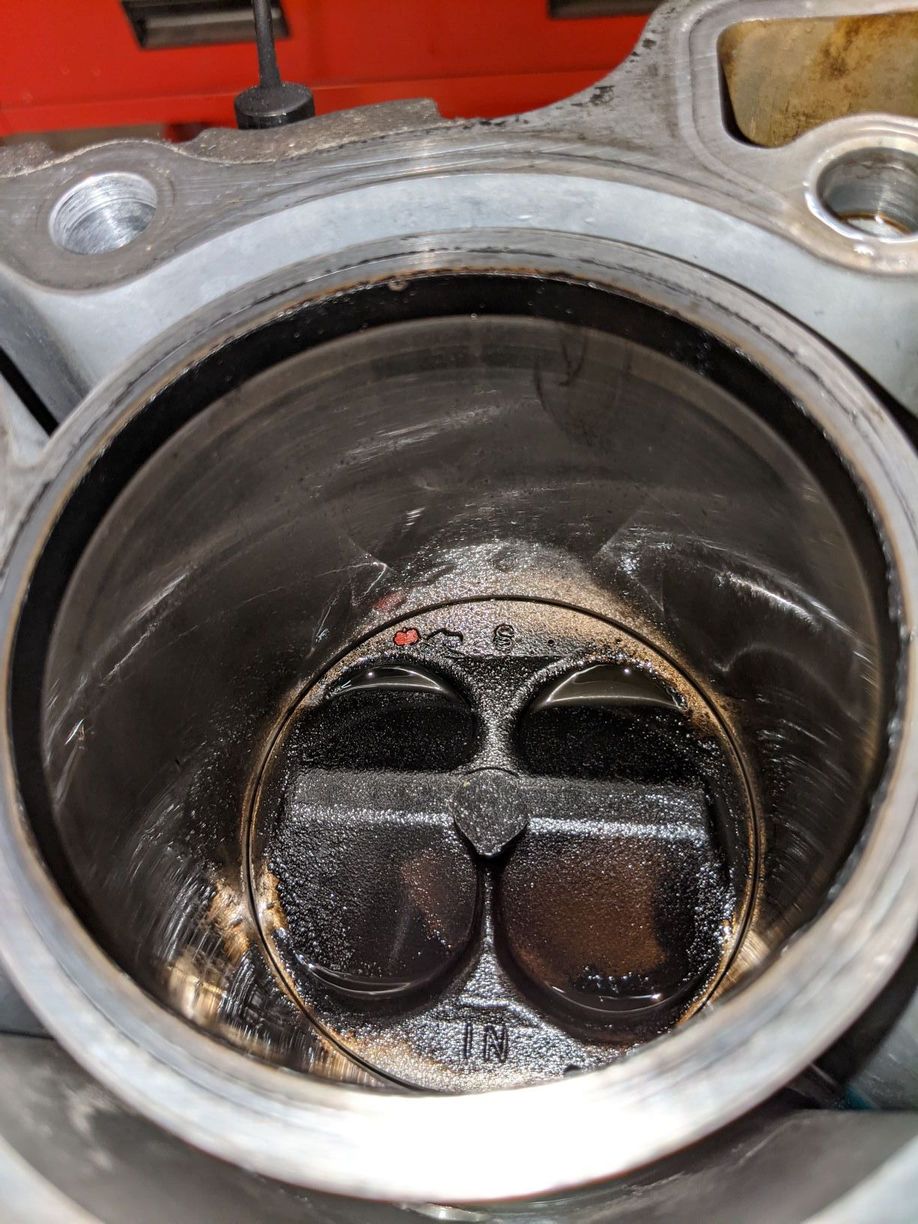

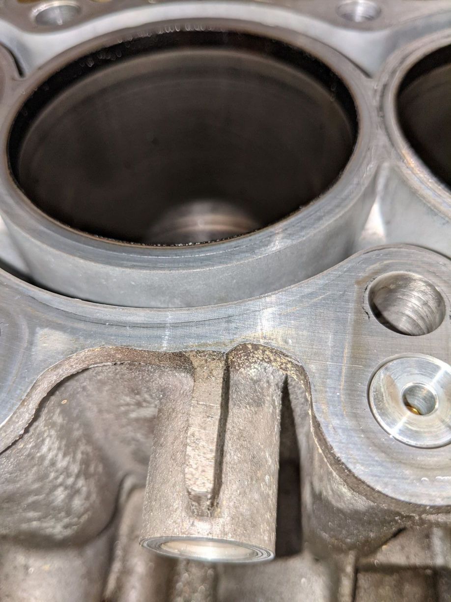

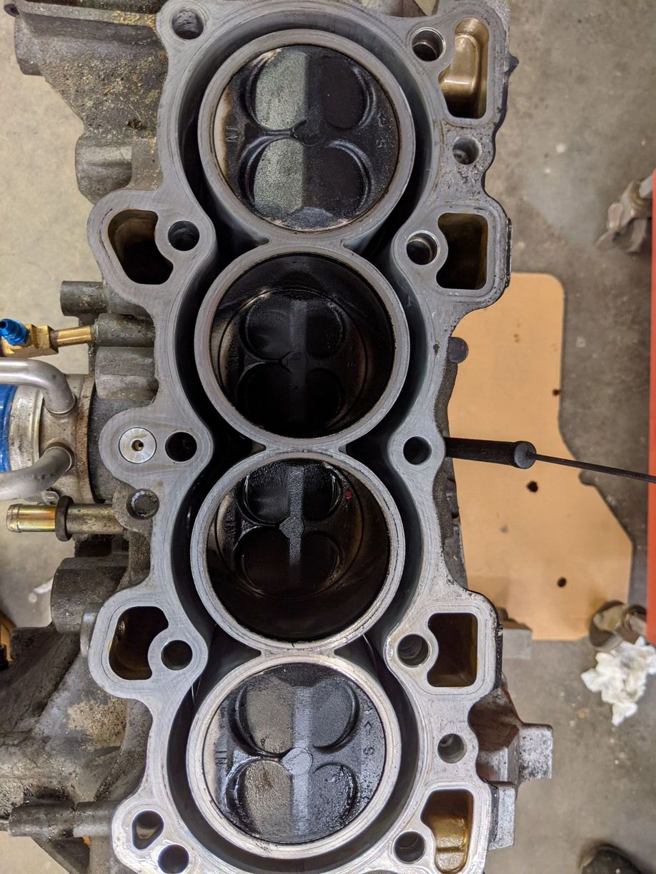

I opened it up today. I may just roll with it... do new gaskets, hoses and cross my fingers. No sludge anywhere. Nothing in the oil pickup besides a tiny bit of silicone. I think the head has already been done. It's cleaner than the block. Some carbon buildup on the pistons and valves but besides that it looks pretty good to me. Car was pig rich though. Spark plugs were totally black.

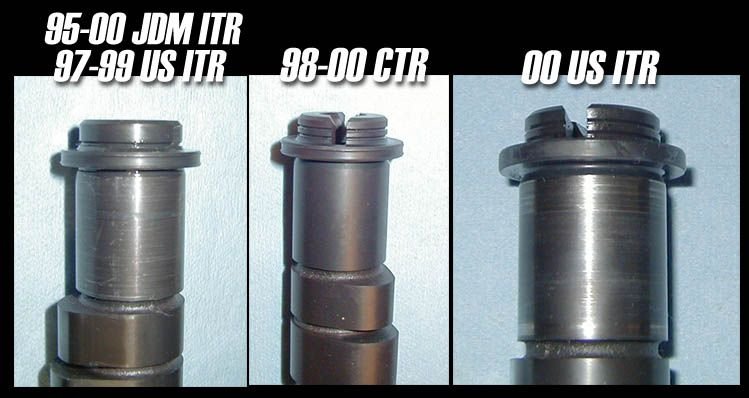

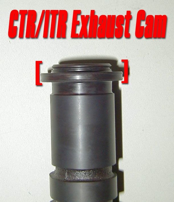

The first thing I did when I got my B16B cams (other than mic them up with my caliper) was to check to make sure they really were CTR cams. They should look like the ones below:
thank you, they do seem to be the correct cams as well. Feeling pretty good about the buy so far. Still 50/50 on whether or not I want to rebuild the bottom end.
