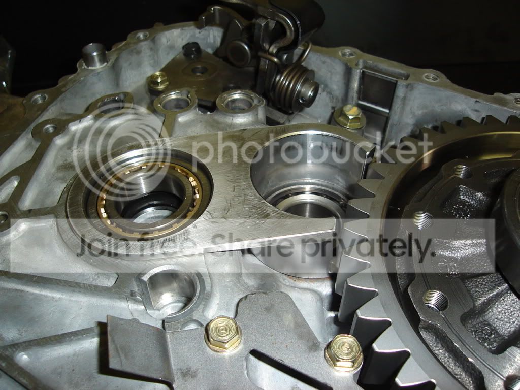

This was done by T1. It was a Liberty gearset w/ 5th gear cuff and welded case.

Was there any welding done on the inside as well? or just inside the clutch side of the bell housing?

damm tepid that cracked already!

Welding was on just the outside. Notice the thickness of the AL....
I didn't do the welding. I noticed that as well.

you just face plated stock gears? If so, YOU DO NOT NEED TO WELD THE CASE.
Thats what you make it sound like. Its the strait cut gears that load the bell housing.
Thats some THICK metal on the case lol we used 3/16 plating and did more plates than that.

I havnt seen anyone mod that. There is a constant load on the bell housing because of the Final drive, the load progressively works outwork on the top case with the gear changes so you only really put a good load on the top case in 4th gear, which is where you should have the 5th gear brace which helps alot.
