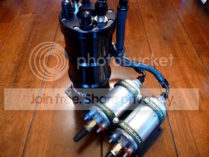

if i run the boschs parallel how would this surge tank work with that
Plumb the Walbro In-Tank Pump into this guy.
The FST already has the Bosch 044s setup in parallel.
Old Jan 22, 2012 | 10:17 AM
  #36
ek9phantom's Avatar
Joined: Oct 2007
Posts: 89
From: plainfield, nj, usa
Default Re: twin inline bosch 044's
where are you mounting this piece of automotive **** lol
does anyone have this setup installed and if so what chassis.
