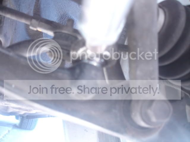

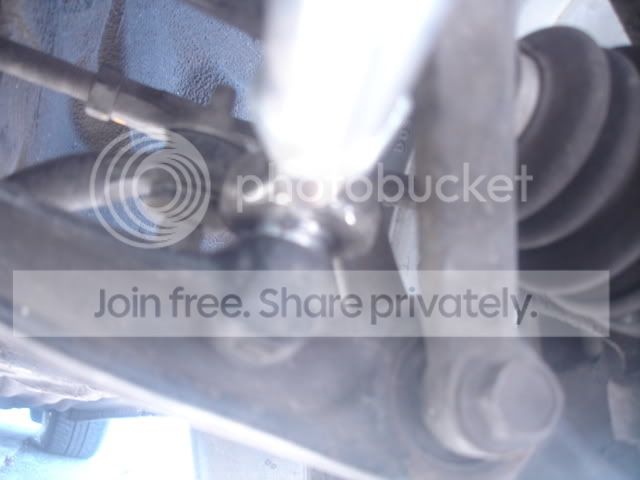

I've had my traction bar on for 3 days now. its a 3rd gen etd. i went and got the car alighned and now when i take off slowly in first or slow down it makes a clunking noise. before the alignment it didnt make a single peep. so i got under the car and messed with the aluminum rods that conect to the LCA. both sides have joints, so thats a totoal of four joints. with my hand i can move the rods, is any of this normal. ill try to post pics later.
im ancious to use the 2 step with the traction bar but need to figure this out first
PICTURES ARE UP!!!!!
its hard to tell but the first pic.
second picture the heim joint is touching the LCA, like i said its hard to tell but when i move it in a twisting manner it makes the same noise like when i drive in first.

With decent heim joints preload doesn't mean anything!! Do they preload the heims on F1 cars? lol besides, I dont think ETD cheaped out on their 3rd generation of this mechanism the status quo has dubbed as the "traction bar". If preloading works to get rid of this noise than all you are doing is band-aiding shitty heim joints or bolts that aren't slip fit.
It could be a few things..
The traction bars 'frame' may be moving around and this will make a random clunking sound, I've see this happen to a CRX where the welded nuts inside of the chassis sheared off - this is because your typical 'traction bars' are inherently a bad design. I always suggest that people stitch weld them on but you wont find that info on honda-tech so it's an insane idea... anyway,
To check to see if the frame is moving around use a yellow metal marker or some touch up paint and draw a perpendicular line where traction bars meet the chassis.
- Take it for a drive
- when you hear the clunk slow down using your e-brake only (I have my reason for this I'm just too lazy to explain)
It should be obvious if the frame part of the traction bars is moving around
Can you twist the bars and mimic the sound with the car on all four wheels?
If so, this is what you want and you will have to live with the sound (another flaw in the design). The suspension needs to be able move around without unscrewing the heim joints... you'll want to make sure that the noise you are hearing is just that and NOT the jam juts cracking loose.
Good luck

im shure you checked , but does the bolt that goes in the hyme joint, fill the hole,
could this just be wrong size hyme or bolt, also wondering why its not connected at strut with a clevis,, its futher out , other brand bars connect there
just reread, you said could mimic sound, twisting bar,, maybe joint is smaking control arm as suspesion unloads,, try adding a washer/spacer of same width of center busing under joint , so sides cant hit ..

That is a very bad design for an EF or DA. chances are that clunking sound is the LCA wrapping around the heim.
Old Feb 29, 2008 | 06:25 AM
EG_H2B's Avatar
Posts: 401
From: The 818
Default Re: traction bar issue (EG_H2B)
Also there is NO WAY to preload that setup with that type of traction bar. Look at your pics, being that there is a heim on the LCA and how high that it is mounted trying to preload the suspension is just going to twist the LCA around the LCA bushings, and will soon lead to destroyed LCA bushings.
