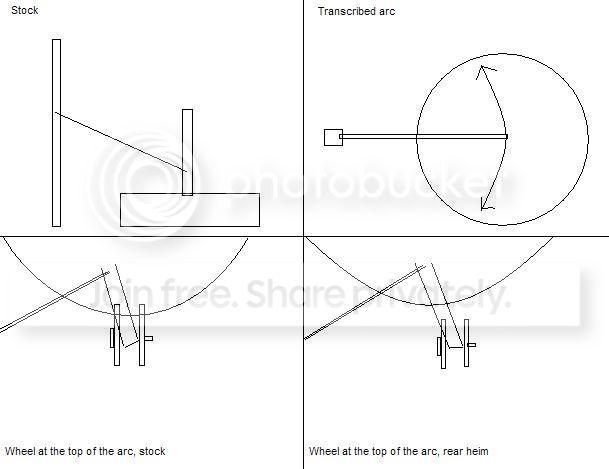

My guess for the JimFabs is to undo the heim from the crossmember and turn that!
That's right dturbocivic... the only joint for the radius arms stock on EFs is flex from the bushings. And since the arm motion inscribes an arc when you view the car from the side, the inner LCA joint binds on the bushing as well, so I would think that it would actually be worse to use two heim joints and have play by the LCA.
Actually come to think of it... having a rear heim would allow the LCA to stay vertical as opposed to twisting the LCA in the bushing.
Here's a diagram of how I see it working... someone tell me if I'm on crack:

So what ur saying is that when u remove the bushing, it no longer has the flex it needs to act as a joint.
When with a hiem joint u will need them on both sides because the radiaus arms dont have that rubber they pull back on when the control arm travels up or down.
