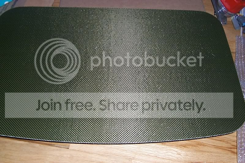

Well exactly what is misleading? If you go back over the 3 years I have been an on and off sponosor on HT you won't see any talk of ribs on the back or anything other than flat. In fact in many of my posts I came out and said this is a flat sheet that is slightly flexible to maintain the roof curve but stiff enough to hold up to the wind. I can site posts from as far back as 3 years ago where I was asked about this. I'm just a little upset you never asked about how stiff it was or ribs on the back and now you are saying you were mislead. If in all my advertising I state what you get and its out there for all to see and then a customer is upset about what they got when they didn't ask how can I help that? If it fit well and holds up at 167 mph what more do you want for a racecar. Like I said I could add more thickness but then you increase weight. We build the panels as light as we can.
Here is a picture I posted in my last sponsor thread of the back of the panel:
Here is the post it came from:
https://honda-tech.com/zerothread?id=1770017
As far as being able to build a panel yourself I'm sure you can. Anyone can dump some resin down and drop some fiberglass but if a vacuum infused panel isn't good enough for you I'm not sure how you would build it. After being in the composites business for 5 years or so and even working on a carbon fiber GM factory program I know how hard it is to make good parts. You seem to be a bit casual about it and it isn't easy to make good parts. There are a ton of companies that try vacuum infusion and give up either due to money running out or getting to fed up with technical issues. We are a company of three and it took 6 months to figure it out. Also you said you didn't want to deal with the mess of building your own panel. If you are set up to do it and do it the right way there should be no mess. Yah wet layup is messy but that really is an inferior way to build parts. Build a panel with wet layup that is the same thickness as our panel and its going to be a lot more flexible. It's funny the guys at the shop opened it up and said "what the hell" and then put it on the car and it held up fine. When there is a steel bracket every 5" or so the panel becomes stiffer than it is just on its own. Walk up to any Honda and press on the metal hood, door panel or stand on the roof, it will give some and even deform but somehow they call it acceptable. I truly am sorry it wasn't what you expected. Since its already in the car I will be happy to offer you a discount on anything we build here as a way of making amends if you ever do order from us again.
