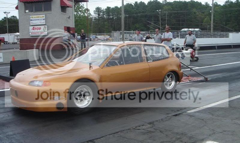

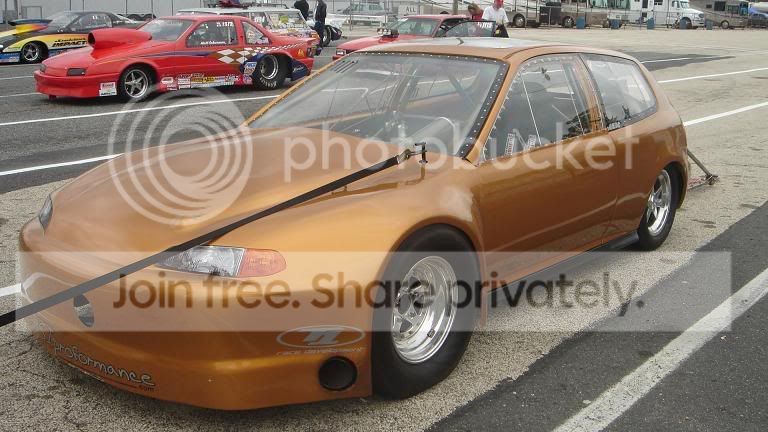

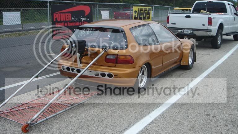

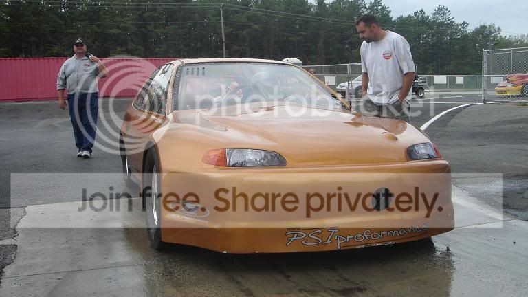

Default someone made it to the track........
http://media.putfile.com/1st-time-out

dang that car looks sweet
still one of my favorites

haha no. i have to make sure its safe to go fast before i actually "go fast" the straight axle that we made is sketchy, the car wiggles in 3rd and 4th gear. you can feel the rear move from side to side.
on the 1st run i just wanted to see how much boost it would make (40-45psi 3rd gear roll on is sick)
2nd run, took the hose off the top of the wg, to run off spring pres, only boost about 8-9 psi.
the 2 step is not working, and i dont know if the boost control is working, but after the 1st run, we were checking the springs in the wg, and noticed the valve on the wg looked to have moved (judging by the grease on the valve) ...... but i also have that Hall sensor for my vss, so in order for the boost to work, the vss would have to be working too. i have the boost setup mph=target boost. i belive the setting i have on that was 35, i will check it later. who knows if it was working, but 3rd gear @40+ was short and sweet. lol
the car is fast as ****, but the straight axle is sketchy, and didnt get its NHRA sticker because i got no D-bars. (half the reason i went to the track today, was to get that stinkin sticker)
shes a runner for sure.

WOW... nice looking car...
almost makes me wanna get another race car...
