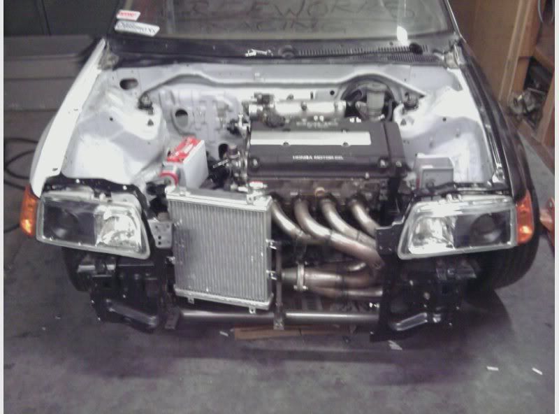

my car had front end damage from when i use to DD it, so when i went to fix it i just bought the outer sheet metal of the core support from honda rather then the whole support. Its a ef civic but if the pics help i have a couple...
but removing the support shouldnt be an issue, just yea need some other means of mounting the radiator etc.

Same here. Well on an ef but its practically the same car. I mounted the rad to the traction bar and there is also a tab off the top of my intcooler that mounts to the hood latch T bracket piece. Still really solid up front.
-Jason
