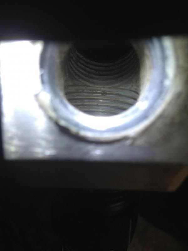

What is everybody using to seal NPT fittings on e85 fuel systems? I tried regular pipe dope but it broke down quickly into a yellow sandy substance

Idk if you can see this, but this is what happened when I used regular permatex dope, it almost turned the dope to a yellow sandy/ powderish state
