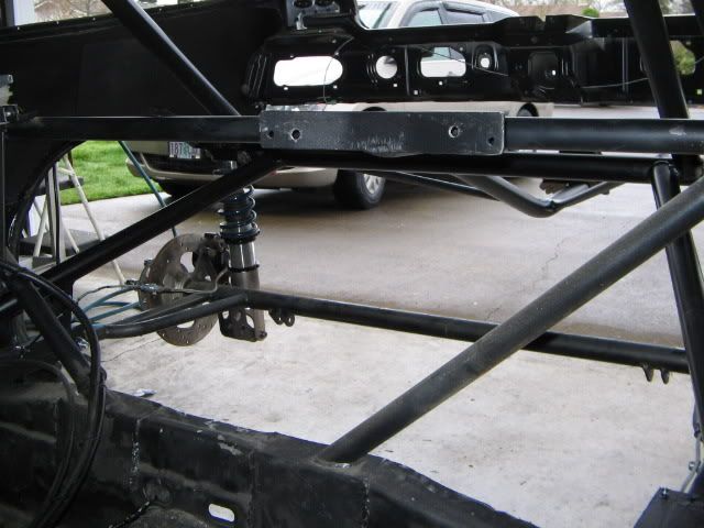

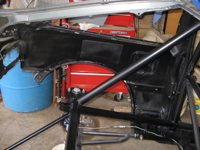

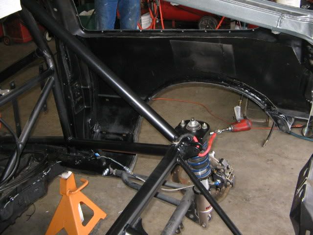

Did I win anything?

That is crazy

Thats sick, but where are the hangers for the exhaust?

Who needs hangers? Weight savings .....lol

Hangers weren't on yet at time of pics. They exist

haha, I just assumed they were well hidin.

wow, what does that CRX weigh in at?

Crx weighs in at 1740lbs track ready without driver. B series turbo car with A/W and schd 40 mani

What did you find was the best way to cut the inner structure off of panels? Cutoff wheel? Sawzall, plasma, air chisel? What's the best method to get those inner structures out, as you've done? Your Rex is hella tight! Appreciate the reply.

Bob, it was a combination of plasma cutter and what it couldn't get, a cutoff wheel was used. Then cleaned it up with an angle grinder with the roloc discs. We made sure to get all the suspension points fab'd before any major cutting. By the way, the entire back half project and lower diffuser was completed by my dad
