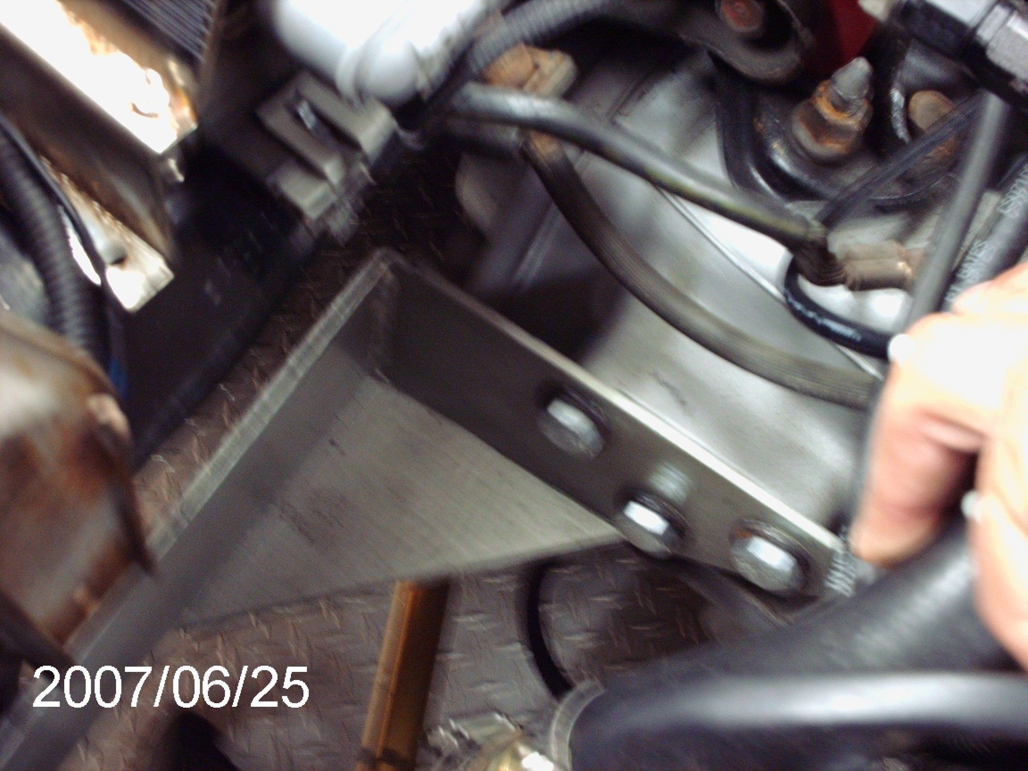

What will the car be used for drag racing or street ?
If drag racing, I had my own mounts made. Solid steel plate, for the crank side going forward and a L shaped with a gusset plate on the front of the tranny going forward. The engine didn't move, yet the shifts were great at 9500rpm.

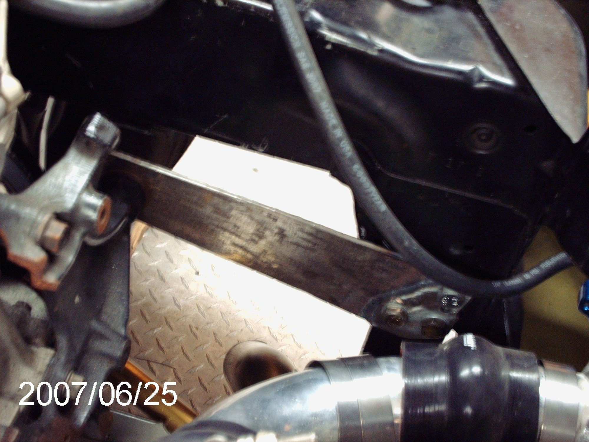

The middle photo shows the three bolts attaching to the front of the frame and the back on the left in the photo to the engine.
