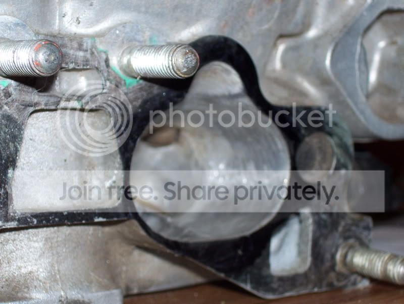

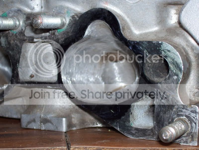

The a6 ports can go pretty big. I ported this one out a bit too much lol
I never ran this head, I just wanted to see how big I could go
