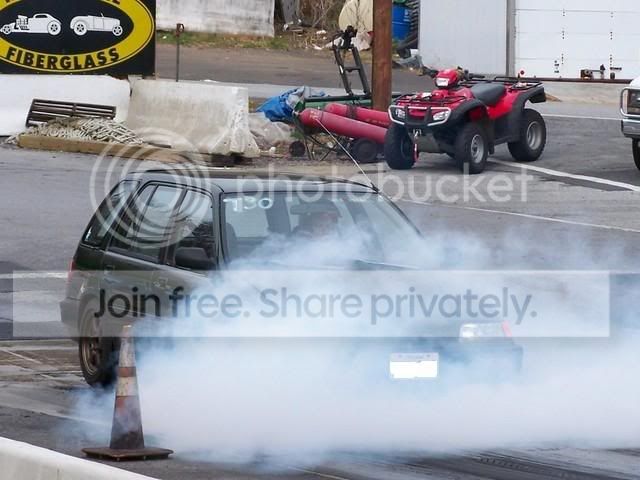

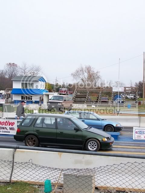

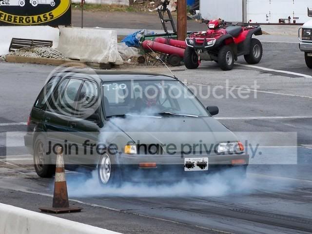

went to the track today for the last test & tune of the year.
22" slicks that are to small and i was shifting to 5th about 90ft
60ft..1.787
13.107 @101.56
then a bunch of 13.1??s after that..
then for fun i ran on street tires 205-50-15 falken 512's
60ft 2.078
13.33 @105 not shifting into 5th. i need to get some 23's and i think i can go 12's

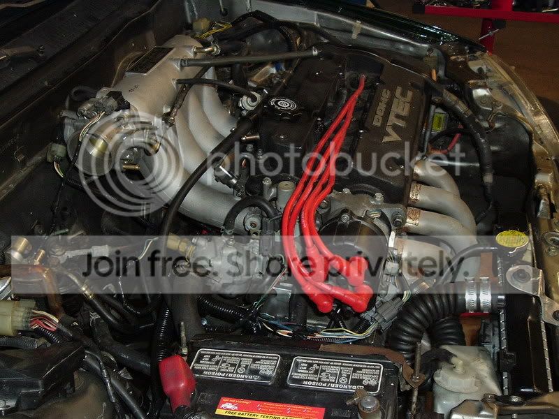

what kit? and mounts? looks sweet!
Old Nov 18, 2007 | 04:54 AM
200TS EC's Avatar
Posts: 201
From: SA
Looks Good!
Old Nov 18, 2007 | 05:55 AM
high_revs's Avatar
Posts: 9,429
From: New Joisey
thats a qsd kit im almost positive, nice driving, what trans? im guessing either b16 or jdm itr
Old Nov 18, 2007 | 08:04 AM
1QwIkEf's Avatar
iTrader: (5)
Posts: 8,697
From: R.I.P Brian Arbogast...you will be missed, maryland, USA
Default Re: h2b wagovan (HondaCivicSiR1)
<TABLE WIDTH="90%" CELLSPACING=0 CELLPADDING=0 ALIGN=CENTER><TR><TD>Quote, originally posted by Victor Vaughn &raquo;</TD></TR><TR><TD CLASS="quote"> </TD></TR></TABLE> my secret i have a wagon the hood clearance is bigger than a ef.lol <TABLE WIDTH="90%" CELLSPACING=0 CELLPADDING=0 ALIGN=CENTER><TR><TD>Quote, originally posted by h2b_eg8 &raquo;</TD></TR><TR><TD CLASS="quote">thats a qsd kit im almost positive, nice driving, what trans? im guessing either b16 or jdm itr </TD></TR></TABLE> its a evo kit with with hasport mounts. ys1 b16 tranny

hmm...manifold looks pretty high, then again it is skunk 2...

<TABLE WIDTH="90%" CELLSPACING=0 CELLPADDING=0 ALIGN=CENTER><TR><TD>Quote, originally posted by HondaCivicSiR1 &raquo;</TD></TR><TR><TD CLASS="quote">evo has a ef kit now?</TD></TR></TABLE> im using hasport mounts. im not sure if they make a kit for the ef or not but i didnt like the way they tilt the motor for hood clearance and bind up the axles

<TABLE WIDTH="90%" CELLSPACING=0 CELLPADDING=0 ALIGN=CENTER><TR><TD>Quote, originally posted by 1QwIkEf &raquo;</TD></TR><TR><TD CLASS="quote"> im using hasport mounts. im not sure if they make a kit for the ef or not but i didnt like the way they tilt the motor for hood clearance and bind up the axles </TD></TR></TABLE>
SO YOU ARE USING A EVOLUTION PLATE WITH HASPORT MOUNTS?

<TABLE WIDTH="90%" CELLSPACING=0 CELLPADDING=0 ALIGN=CENTER><TR><TD>Quote, originally posted by Hamstr323 &raquo;</TD></TR><TR><TD CLASS="quote">
SO YOU ARE USING A EVOLUTION PLATE WITH HASPORT MOUNTS?</TD></TR></TABLE> yep

<TABLE WIDTH="90%" CELLSPACING=0 CELLPADDING=0 ALIGN=CENTER><TR><TD>Quote, originally posted by 1QwIkEf &raquo;</TD></TR><TR><TD CLASS="quote"> yep</TD></TR></TABLE>
really like the way it sits! can you snap a pic ot the drivers side mount?
