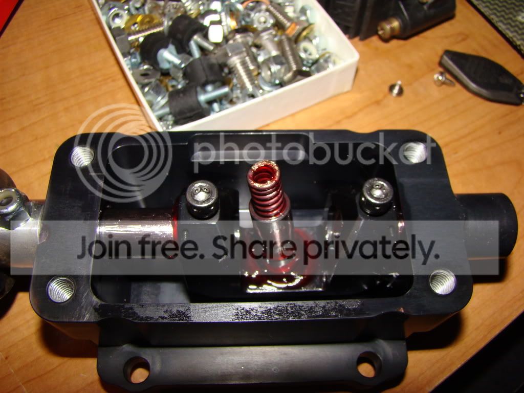

I'm also curious about what t1 machines on the shifter. I picked up a used unit on here last year and it kept popping out or wouldn't go into gear with solid mounts still. Wondering if it was an earlier unit before they started modifying them. I need to sack up and take this thing apart, but of someone has some insight that would be helpful.

if you take the top plate off with the 4 socket head screws and just shift it forward and backward, you will see where it hits; that is what needs to be shaved down to get more "throw". the area that is already slanted is where it ends up binding.
