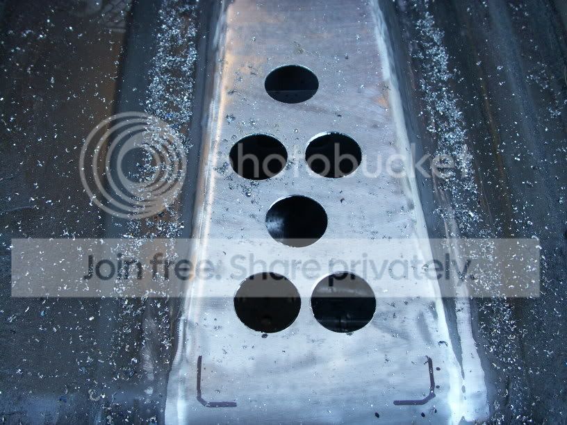

I made my sump myself.... Full-Race style....
I don't have updated pics of it all welded up, but I did not go with F-R because I needed a 12AN outlet on the sump. I wanted to take full advantage of my Eliinator fuel pump.

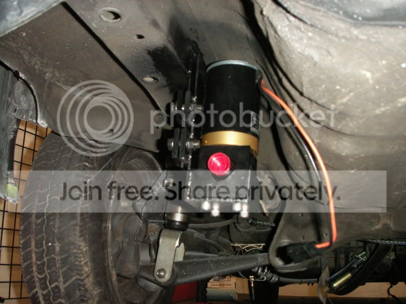

Here is the pump mounted too with fuel lines run....

As far as return, I am using the stock feed line and returning through that. It has worked well so far.

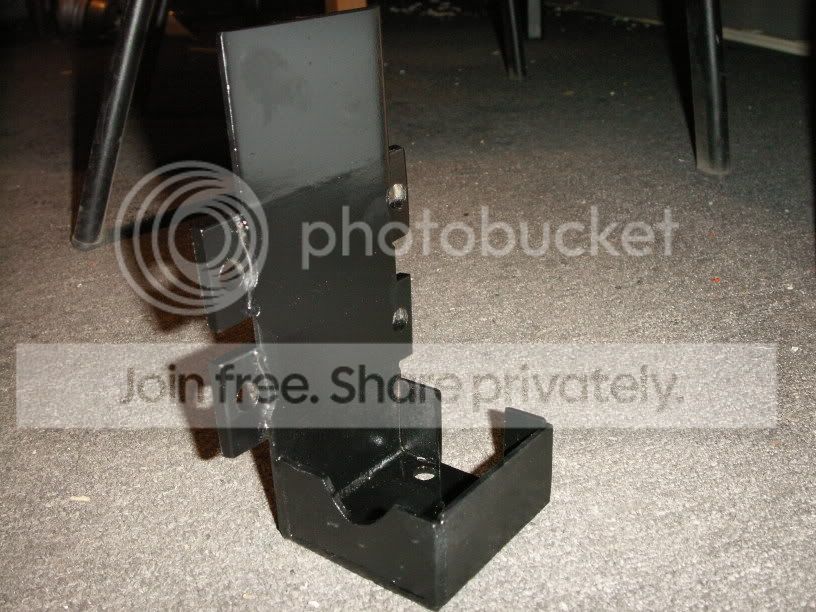

If you searched, I'm sure you've seen the way Scott and I do it, but incase you haven't here's a couple pics... And as far as the return, I don't have any resized pics loaded up, but I'll try to get one ASAP. Pretty simple though (and something we changed on one of the last SFWD cars we did), just welded a -10 fitting onto the bottom, front side of the tank, and ran the return straight into it. That's as apose to going back over the tank, which when you're running anything decently big line (that has requires big fittings), doesn't fit under the OE fuel pump access plate in the back of the car.
P.S. - Incase you can't tell, it's a Comp. Engineering sump.

Look at my pics above. I welded a 6AN line fitting to the top of my fuel pump cover and have a tube going to the mid section of the tank.

<TABLE WIDTH="90%" CELLSPACING=0 CELLPADDING=0 ALIGN=CENTER><TR><TD>Quote, originally posted by integra_gsr98 &raquo;</TD></TR><TR><TD CLASS="quote">A few more pics...
is this an incorrect way of running the lines as it has to make an uphill climb before it hits the pump? wouldnt this increase chances of vapor lock and starvation?
