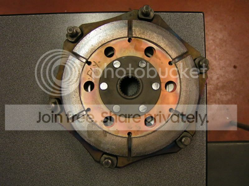

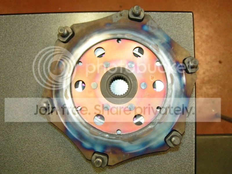

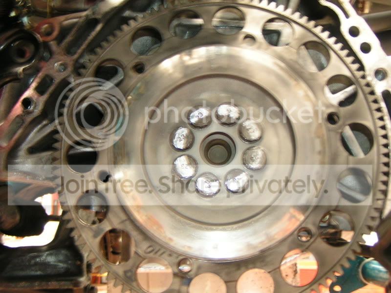

Ok , thanks for the reply. Think i found the problem. Probably the disk to the flywheel was install on the wrong side.
here's some pic :
Think this one as to go the other side
rivet grinding against the flywhhel bolt
a lot of heat
if anyone as pic or the crrect order for disc let me know

My disc have letters telling which disc faces what side so I cant say which one goes where. I also had a problem with the rivets rubbing the flywheel bolts so I grinded the bolts down a bit. Also the disc cant be lined up exactly the same. Once its installed, when you look through the big holes of the first disc, you must see the smaller holes in the second disc on the flywheel side. I have the instruction but no scanner so let me see if i can take a picture and post it.

Heres a picture of the disc that faces the flywheel.
This is the same disc but this side it pointing towards the tranny.
As you can see the side that faces the flywheels is the side with the black circular thing haha
This disc is the last one to go on and you can see the center spline area its raised. This faces the pressure plate.
Hope that helps.

Not sure if this is your problem or not but...
on the Exedy twin disk, the disk that says FW isnt the side of that disk that "faces" the flywheel. That is just the disk that sits on the flywheel side. The other disk sits on the other side of the middle ring, being closer to the p/plate. Which way each disk sits in its respective locations is pretty straightforward to determine, they only seat nicely one way. Lastly, Exedy indexes everything with some white or blue paint.

Very true,
we found this out when installing our clutch, the flywheel disk should face with the rivits out (twards pressure plate), otherwise the stack wont sit properly...

A lot of heat because the clutch was slipping
