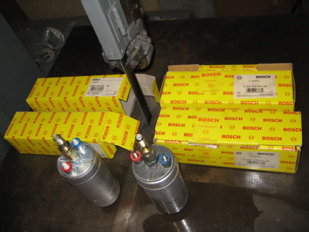

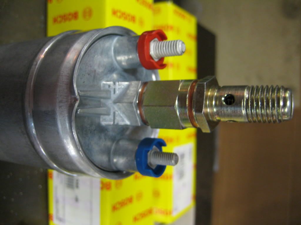

From another forum I barrowed this post and a couple pics.
Real on left, fake on right...
Fake label and stamping...
Real label and stamping...
Fake...
Real...

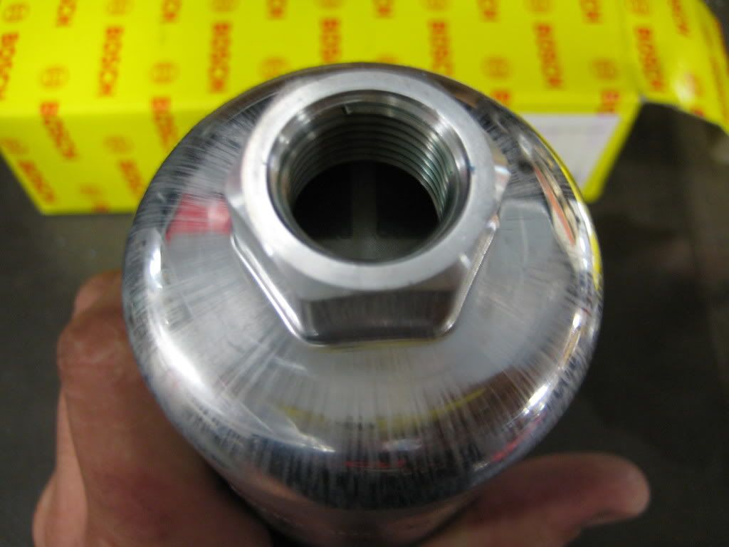

I'm kinda anxious to see what you end up with Chris. Every 044 I know of has a 18mm female inlet. The ebay ad says 14mm... And most of the Porsche models they specify this as a replacement for is incorrect. The correct pump would be the 979.
Old Jan 13, 2010 | 10:08 AM
SwappedTURBOegg's Avatar
Posts: 2,499
From: MI
Default Re: ebay FIND bosch 044's 120 shipped
good thing you noticed that, i was about to order fittings. ill hold off on that now.. hope its just a typo.
Old Jan 13, 2010 | 10:11 AM
Posts: 2,499
From: MI
the label looks fake oops lol
this issue came to head a year or two back, some people on this site were slingling the bootleg 044's if I remember correctly.
Best price I found so far for genuine 044's is $175ea
Everybody on this site use to ***** them out for $250 until I guess they realised Titan had been selling them for $190 for a long time, now the prices are $190 lol
Old Jan 13, 2010 | 11:23 AM
E85B18's Avatar
Joined: Feb 2009
Posts: 1,204
Damn that fake looks so real.
Old Jan 13, 2010 | 11:37 AM
hybrid_KJ's Avatar
Joined: Jun 2001
Posts: 590
From: Tampa, FL, USA
so the fakes are etched "made in Germany"
and the reals are stamped "made in Czech Republic"
Has anyone had a known real one say "Made in Germany"?
