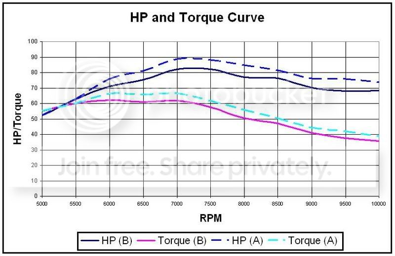

because it contains oxygen. C2-H5-O-H is the molecular formula for ethonal.
dashed lines are e85. solid lines are vp race fuel(110 or 112. its been 3 yrs so i cant remember off the top of my head) AFR tuned for both. ign timing left the same so maybe that could have helped the VP. both done on the same day. superflow engine dyno. cbr 600cc turbocharged engine with 19mm restrictor. take it for what its worth i guess.
