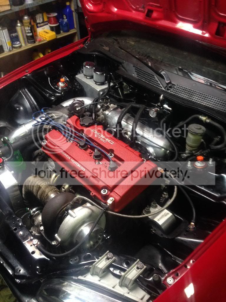

heres a pic of the setup. There were really no corners cut. All vacuum lines are pushlock/hard lined. Car runs smooth as stock.

looks like a great, clean setup...i am a little jealous..
it is still a little difficult because i would prefer to actually be looking at how all the vacuum lines are set-up...seeing what is hooked up where ya know?

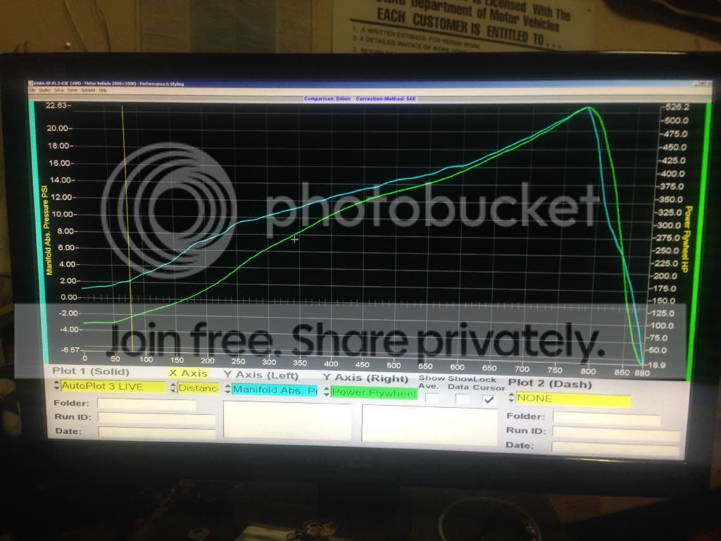

It's a sheepy top mount. And I feel like regardless of when the valve starts opening, the boost should plateau at some point if it was a spring rate issue. This car would keep making boost the higher it was spun, as you can see on the graph.

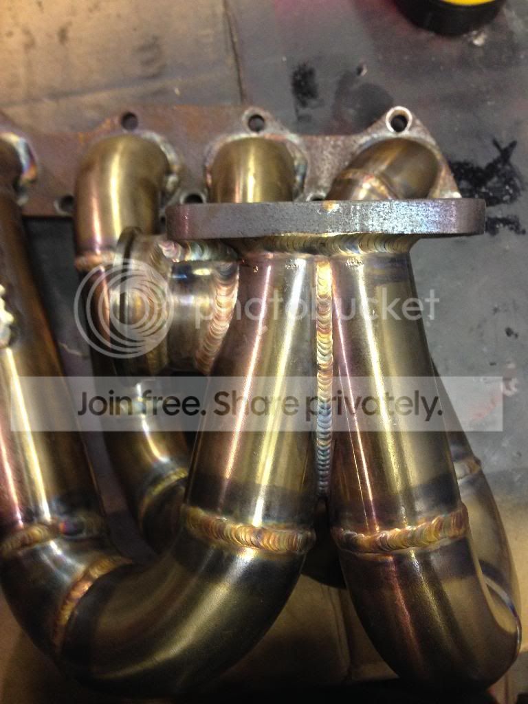

The entry to the gate isn't helping anything. To keep it where it is you'll prob need a 6Xmm gate. If you add another gate, give it some radius on the entry.

Short collector is still gonna creep regardless of the gate size.

Our sheepy manilfold being a short collector?

Yes. There isn't a chance for the exhaust energy to make that sharp turn so it just goes through the turbo instead.
