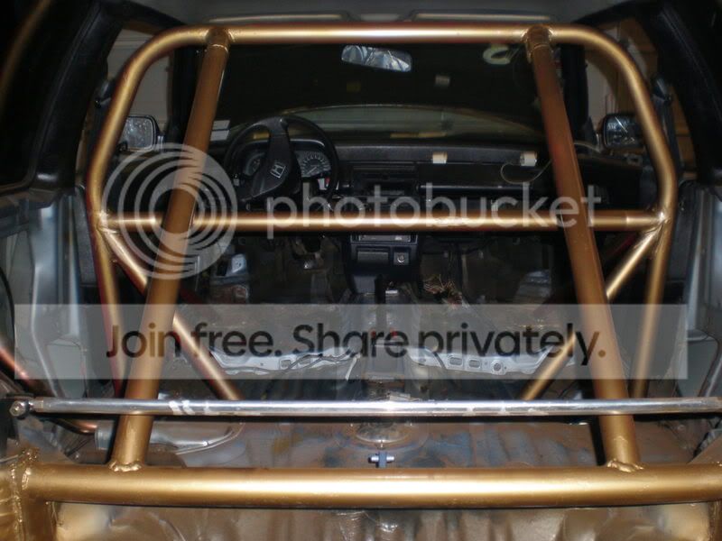

oops wrong cage lol Mines a 10pt, i have the halo and the front bars also. I didnt look good enough at the pictures. The diagonal bars....they have to be welded to a bar that crosses the car, they cant be welded to the floor on plates. I had to change that in my cage to get it certed. And i just realized i used the jegster roll cage, not the CE so look into them. I mean the 10pt was only about 380 shipped, and then your safe for as fast as you wanna go.

Old Nov 2, 2007 | 05:52 AM

the d bars in that pic, technically arent legal, but the dude that cert'd the chassis, told us to put them that way.

Default Re: (texastype_r)
<TABLE WIDTH="90%" CELLSPACING=0 CELLPADDING=0 ALIGN=CENTER><TR><TD>Quote, originally posted by texastype_r &raquo;</TD></TR><TR><TD CLASS="quote">
that is not good fittment!

Default Re: (miller)
Agreed. Looks horrible

Default Re: (boostedcivicsir)
So is this fitment bad because all the bars don't meet up in the same place? Like the door bar, cross bar, etc don't meet together on the main hoop?

Default Re: (sorrule)
<TABLE WIDTH="90%" CELLSPACING=0 CELLPADDING=0 ALIGN=CENTER><TR><TD>Quote, originally posted by sorrule &raquo;</TD></TR><TR><TD CLASS="quote">
Modified by sorrule at 1:36 PM 11/2/2007</TD></TR></TABLE>
Look at the gaps between the cage and the car.. the tighter everything is the better.
