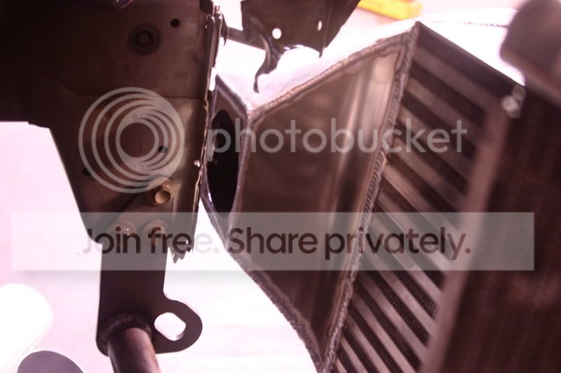

few more
more next week

Nice looking welds on that manifold.

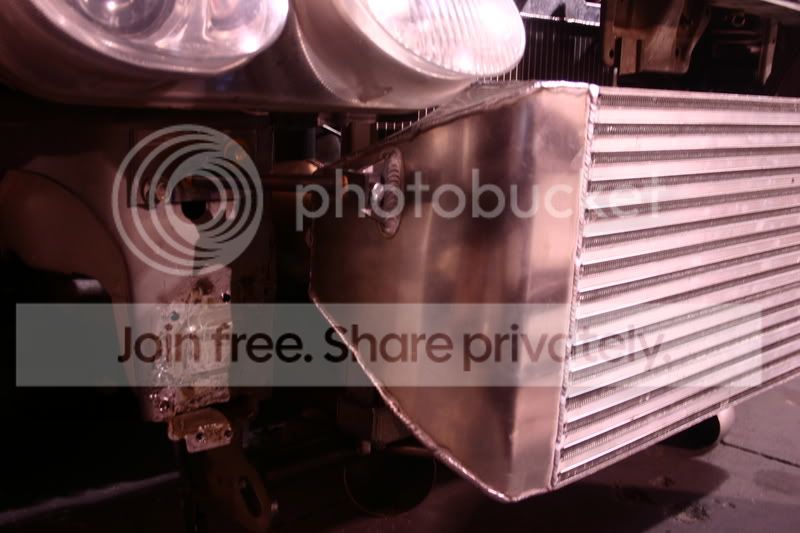

I love those endtanks. Can u make those for precision 750hp intercooler. Pm me price

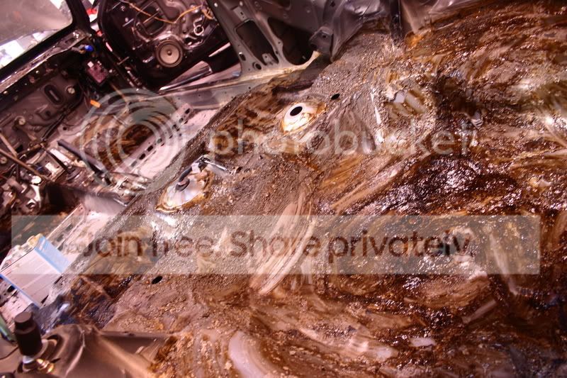

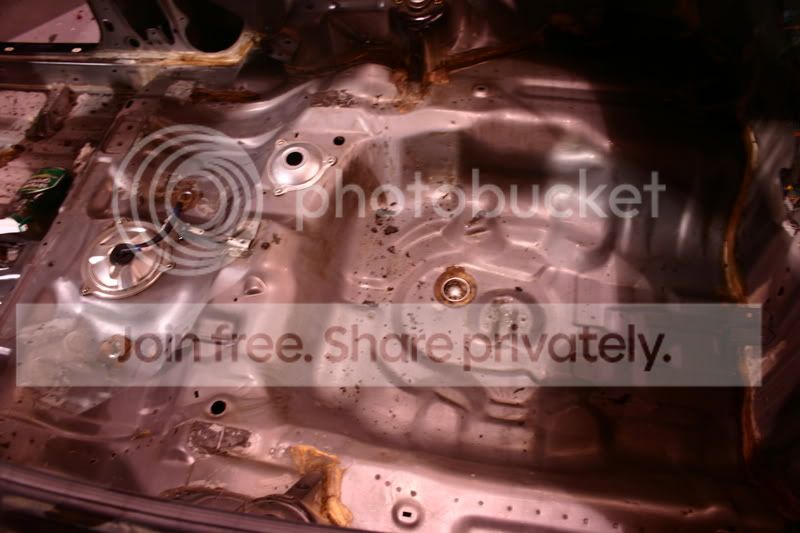

What's the goop that you used on the inside to get is so clean?

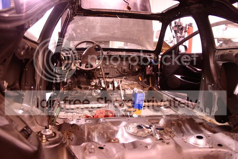

it was low odor aircraft remover you can pick it up at most automotive stores but let me tell you that stuff is a pain and damn near ate the skin off my hands
we have a little more cleaning up to do but it does look pretty gnarly kinda did it on accident
and pm'd on the endtanks
maybe have some inlet pics up next week

<TABLE WIDTH="90%" CELLSPACING=0 CELLPADDING=0 ALIGN=CENTER><TR><TD>Quote, originally posted by taggart_lumpy &raquo;</TD></TR><TR><TD CLASS="quote">it was low odor aircraft remover you can pick it up at most automotive stores but let me tell you that stuff is a pain and damn near ate the skin off my hands
I'll bet the directions on the can say to use gloves to protect your hands. Most Auto Parts stores carry latex or non-latex gloves.

the aircraft remover
I used 3 latex gloves on each hand and it ate through that after about 10 minutes so I finally got some expensive chemical resistant gloves but it seemed to get through those too after about 20 also
if anyone uses it I'd just do the latex and keep putting on new gloves

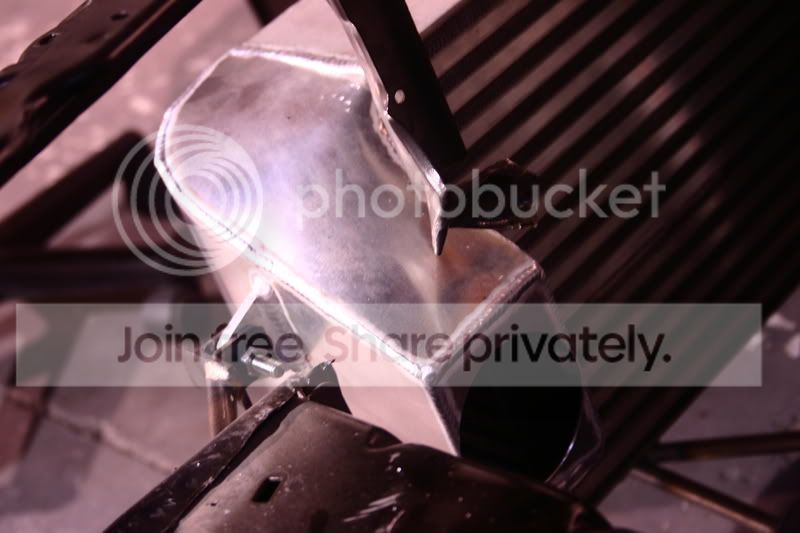

how much for one of the top mounts? pm me. lsvtec with b16 head.

when i used aircraft paint remover i always brushed it on to whatever i was removing the paint from.

On a side note, a good way to get rid of sound deadener is to use dry ice. either block or sheet. You put it on the floor, leave it for 5 mins then with a hammer give the floor a tap and it falls off.
Keep working in the same area as you want the floor to be a cold as possible. If you buy 4 blocks (160mmX70mmX50mm) you can do a whole car pretty quick and it cheap.
The best part is that there is bugger all mess, you just sweep and vaccum the car out when your done

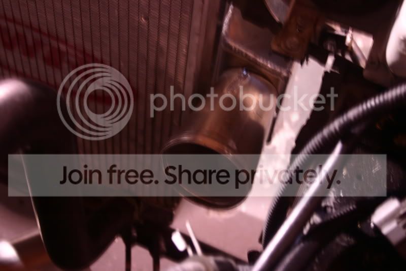

looking good. Did you have to move the radiator to compensate for 3 1/2" piping?

the sound deadening actually really suprised me i would put it at about 45lbs give or take a few pounds
and no the rad is still in the stock location but i believe we may be moving it to tinker with some other things
