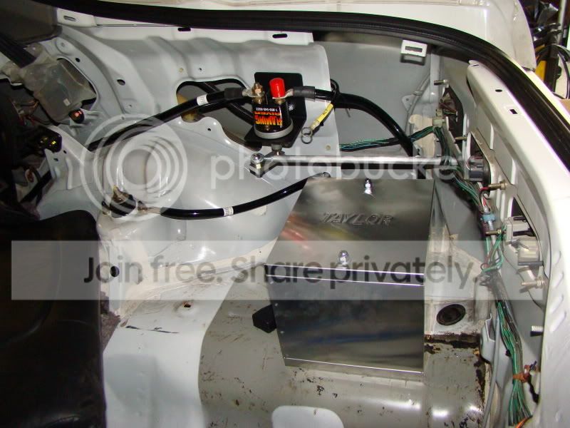

Here is mine....
Very easy to install. It's so easy even a Paki can do it....

That setup is sick. I guess I'm gonna order falming river one today.
Paki can do it all night long
Which post does the alternator wire go on?
Old Jun 25, 2007 | 08:52 AM
tepid1's Avatar
Posts: 8,357
Likes: 5
From: CT
Default Re: Battery Kill Switch (Turbocivic94)
<TABLE WIDTH="90%" CELLSPACING=0 CELLPADDING=0 ALIGN=CENTER><TR><TD>Quote, originally posted by Turbocivic94 &raquo;</TD></TR><TR><TD CLASS="quote">
Which post does the alternator wire go on?</TD></TR></TABLE>
It goes on the battery side.

<TABLE WIDTH="90%" CELLSPACING=0 CELLPADDING=0 ALIGN=CENTER><TR><TD>Quote, originally posted by tepid1 &raquo;</TD></TR><TR><TD CLASS="quote">
It goes on the battery side.</TD></TR></TABLE>
If it goes on battery side how does it kill the alternator cause you are still getting power from the battery.
Old Jun 25, 2007 | 09:48 AM
tepid1's Avatar
Posts: 8,357
Likes: 5
From: CT
Default Re: Battery Kill Switch (raene)
<TABLE WIDTH="90%" CELLSPACING=0 CELLPADDING=0 ALIGN=CENTER><TR><TD>Quote, originally posted by raene &raquo;</TD></TR><TR><TD CLASS="quote">
Is it just me or does your window say something about loving ****?? Haha!</TD></TR></TABLE>
Why yes it does....
Old Jun 25, 2007 | 09:50 AM
tepid1's Avatar
Posts: 8,357
Likes: 5
From: CT
If it goes on battery side how does it kill the alternator cause you are still getting power from the battery.</TD></TR></TABLE>
Thats power FROM the alt to the battery. It works like this.... With the motor running and the switch closed the alt charges the battery and the rest of the system. With the switch open it kills the alt output power and the battery at the same time. I have tested it and it does work.... I know my electronics.
